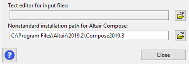

External Responses using Altair Compose
Invoking Compose to specify the installation path.
If Altair Compose needs to be invoked during the OptiStruct job in case of external responses (DRESP3), the installation path for Compose must to be specified by the user.
Figure 2.- Options field
For further details, refer to -compose in Run Options.

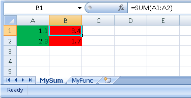

Microsoft Excel workbooks can be referenced via the LOADLIB entry to define user-defined responses.
Both Implicit and Explicit options are available and are defined here.
LOADLIB DRESP3 ELIB dresp3_excel.xlsx
DRESP3 10 SUM ELIB MYSUM
+ DRESP1 5 6
Figure 4.

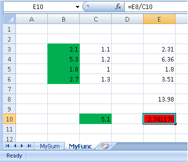

DRESP3 20 FUNC ELIB MYFUNC
+ DRESP1 5 6 7 8
+ DESVAR 1
+ CELLIN B3 THRU B6
+ CELLIN C10
+ CELLOUT E10
Figure 5.
