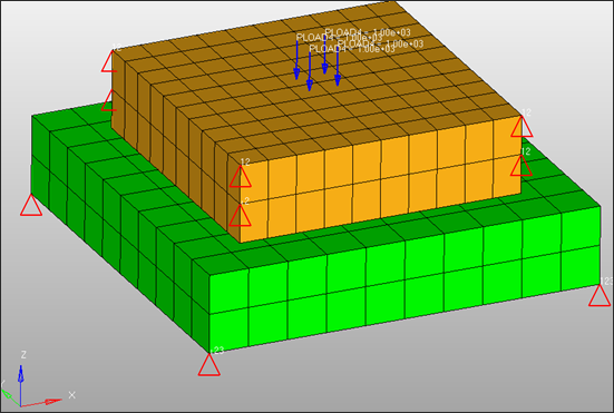

Figure 1 illustrates the structural model used for this tutorial, which is two square solid blocks made of elasto-plastic steel material. The dimensions of the blocks and the material parameters are outlined below Figure 1.
Figure 1. Model and Loading Description

- Imposed pressure
- 1000.0 MPa, applied at the center of top block

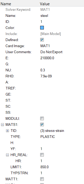

Create Elasto-plastic Material

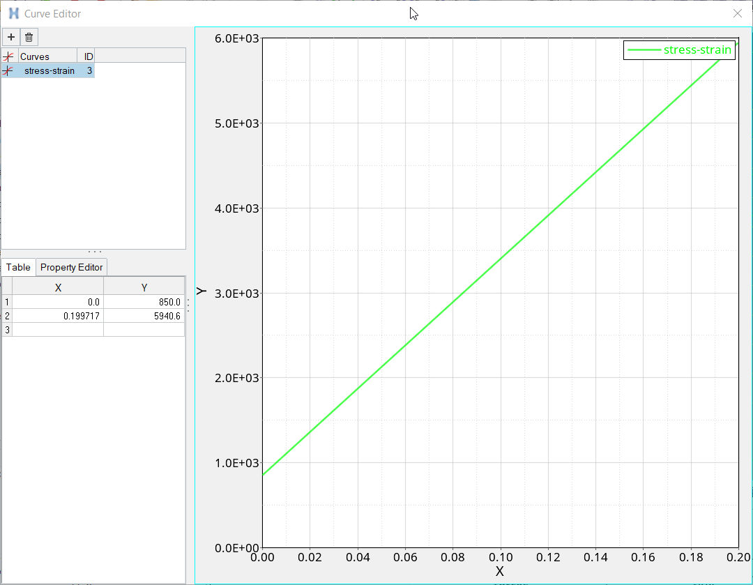

First, the stress versus plastic strain curve for the material needs to be defined.
Now, the elasto-plastic material needs to be updated.

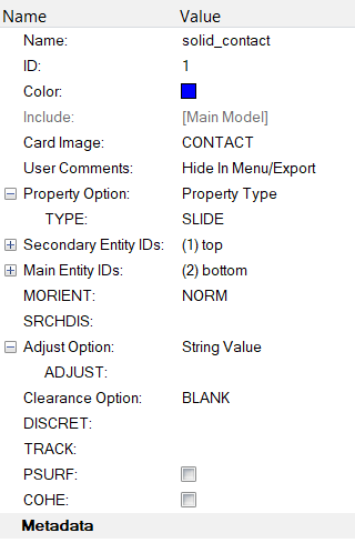

Define Contact between the Blocks
Next, the interface needs to be defined.

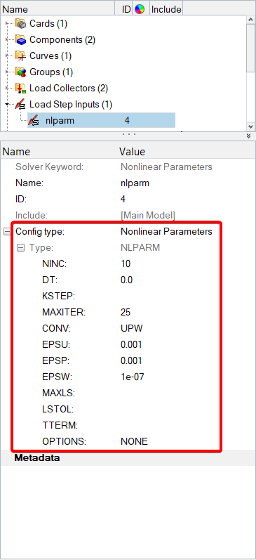

Create NLPARM Load Step Input

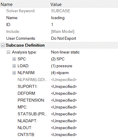

Create the 1st Nonlinear Load Step

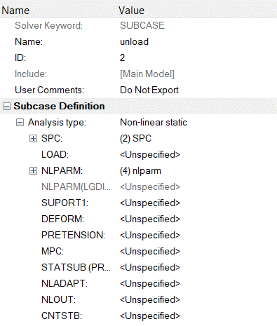

Create the 2nd Nonlinear Load Step

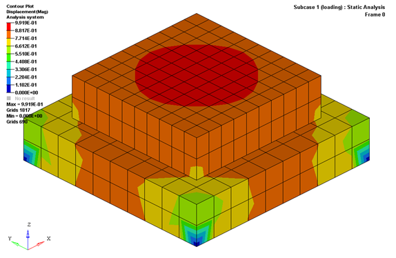

Figure 10. Contour of Displacements in Blocks Subject to Loading

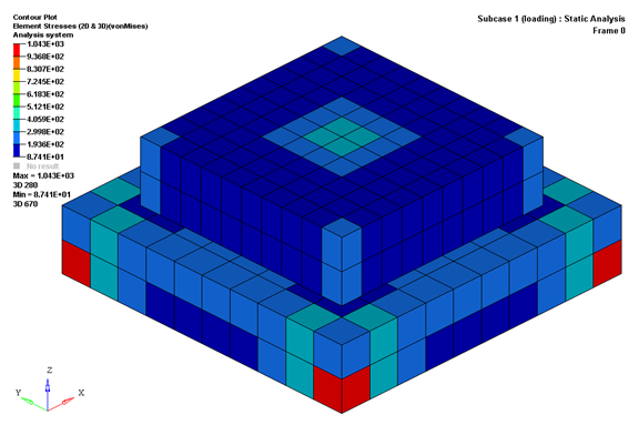

Figure 11. Contour of von Mises Stress in Blocks Subject to Loading

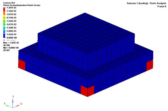

Figure 12. Contour of Plastic Strains in the Blocks Subject to Loading

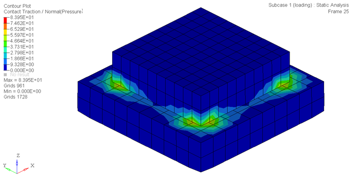

Figure 13. Contour of Contact Pressure in the Block Interface After the 1st (Loading) Subcase

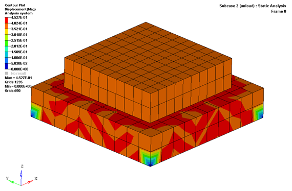

Next, change the subcase to the 2nd that is unloading subcase and plot the displacement contour to see the change in displacements in the blocks subject to unloading.
Figure 14. Contour of Displacements in Blocks Subject to Unloading in 2nd Subcase
