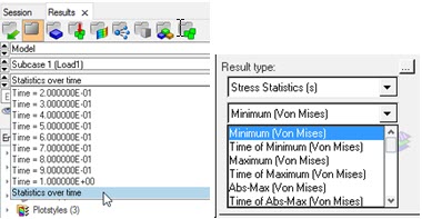

- Stress Statistics are only
supported for Direct and Modal Linear Transient Analysis. Only Centroid stress
is supported and only 2D and 3D elements are currently supported.
Only H3D output is supported for Stress Statistics.
The following statistics over time are output for Linear Transient Analysis when STATIS or OSTATIS is specified:- Statistics
- Supported Stress Result Types
- Minimum
- von Mises, P1 (Major), P2 (Mid), P3 (Minor)
- Time of Minimum
- Maximum
- Time of Maximum
- Abs-Max
- Time of Abs-Max
- Arithmetic Mean
- Root Mean Square (RMS)
- Variance
- Standard Deviation
After loading the H3D file, the Stress Statistics in HyperView can be viewed.
Various statistics can be chosen from the sub-menu under Stress Statistics(s).
Figure 1. - The default location of stress output can be defined using the OutStress keyword on the OptiStruct configuration file (optistruct.cfg).
