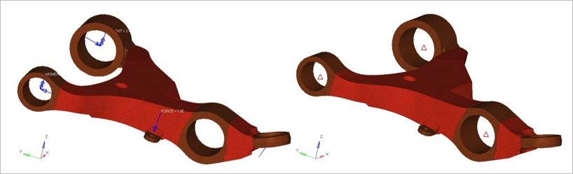

Topology optimization of control arm is solved for:
Analysis Type
Linear Static
SPC
Force and Moment
Optimization
Topology
Objective: Min Volume
Subject to: Local stress constraint

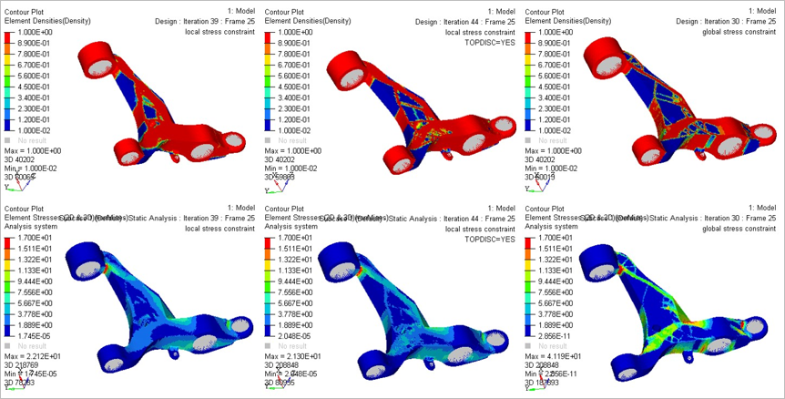

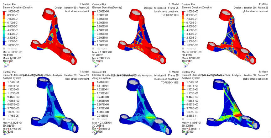

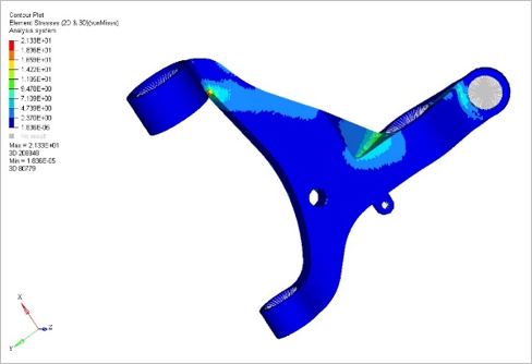

Figure 2. Element Stress Plot
OptiStruct provides the Element density information for all of
the iterations (Figure 3 and Figure 4). In
addition, OptiStruct will also show Displacement and von Mises
stress results of a linear static analysis for iteration 0 and iteration 44 (Figure 2). Figure 3. Element Density Contour Figure 4. Element Density Contour (different view)
