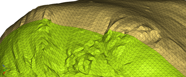

Intersections will prevent correct deployment of the bag and should be removed. There should be no intersection on the self-impact contact of the bag or between the bag and the environment. Intersection can be checked in HyperMesh or HyperCrash.
Penetrations are common in the self-contact of a folded airbag. The ideal case would be to have no penetration at all. The flag Inacti=6 adjusts automatically reduces the gap to prevent initial contact force caused by penetrations. However, after the automatic reduction, there still needs to be an adequate gap. Therefore, the maximum penetration should be less than 95% of the contact gap. A penetration check can be done in the HyperCrash or HyperMesh penetration checking tool.
