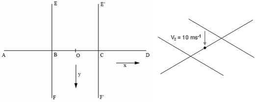

Figure 4. Geometry of the Frame
Dimensions are: AB = BC = CD = BE = BF = E'C = CF' = 90 mm.

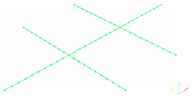

Figure 5. Mesh of the Frame Showing the Position of the Nodes

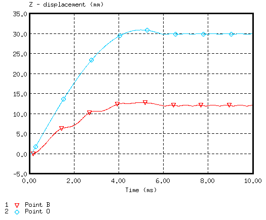

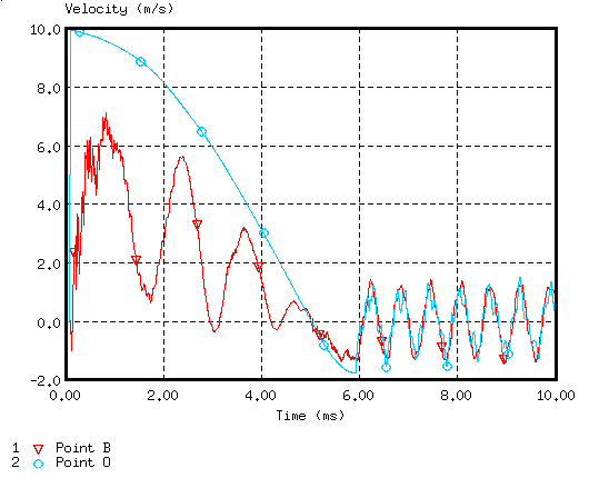

Figure 6. Displacements of Points B and O
Figure 7. Velocity of Points B and O (stabilization)

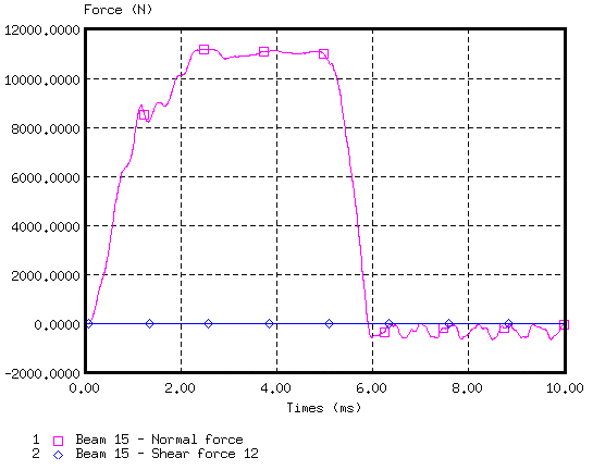

Figure 8. Normal and Shear Force on Beam Element 15 (near to point O)

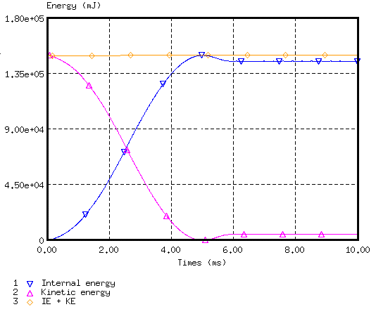

Figure 9. Energy Assessment (stability reached at in 6 ms)

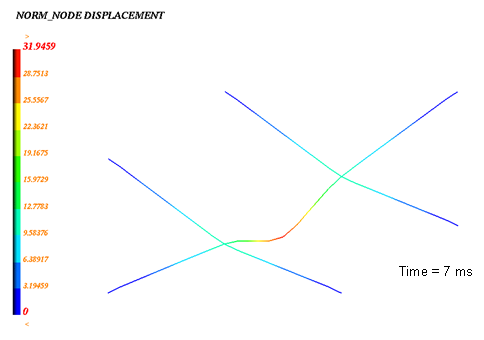

Figure 10. Node Displacement (max. = 30.96 mm)

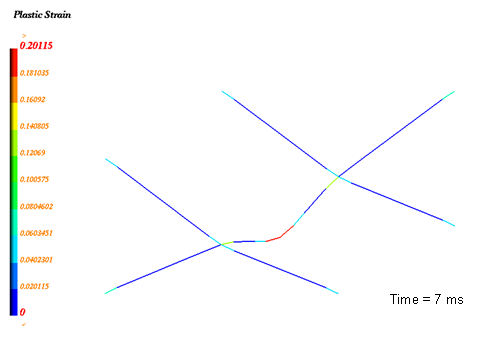

Figure 11. Plastic Strain (max. = 20.1%)
