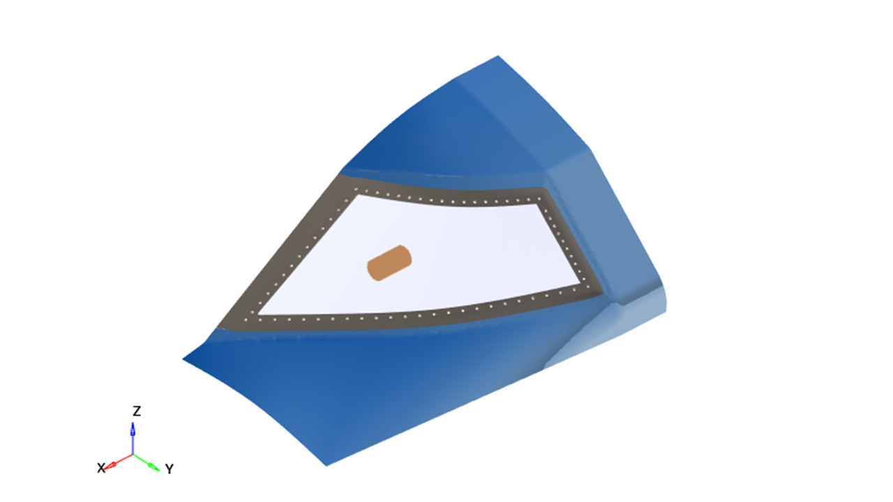

Model Description
Figure 2. Problem Description
Units: mm, ms, kg, KN, GPa
The bird model has following characteristics.

- Bird modelingThe bird model consists of 11190 particles, the distribution follows a hexagonal compact net. The cell distribution must be cubic face centered. The diameter of each particle is about 5.0 mm.
Figure 5. Perspective View of the Cubic Centered Faces Net - SPH simulation setupIn order to define the SPH bird, the following keywords are needed:

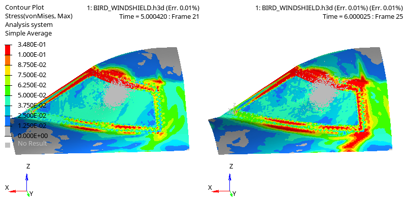

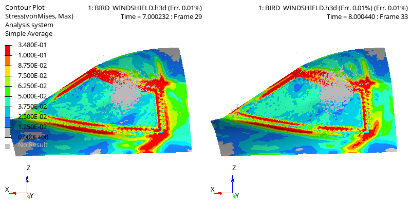

Figure 6. von Mises Stress at time 3ms~8ms

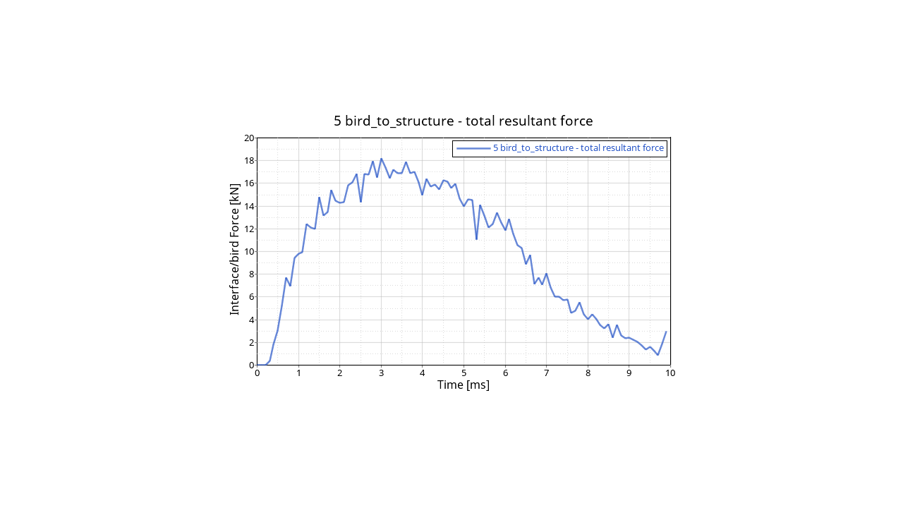

Figure 7. Interface Force between Bird and Windshield
