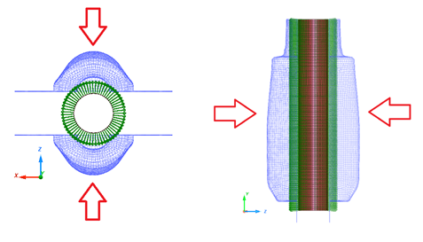

Using rigid body, two molds have been fixed in all direction of rotation and translations of y-direction and x-direction. They are only free in z-direction (translation).
- Impose displacement (/IMPDISP)
Two molds are moved in opposite directions with imposed displacement.
- Pressure Load (/PLOAD)The air pressure on the plastic parison is modeled using pressure load /PLOAD from inside towards outside.
Figure 2. Pressure Load on Plastic Parison

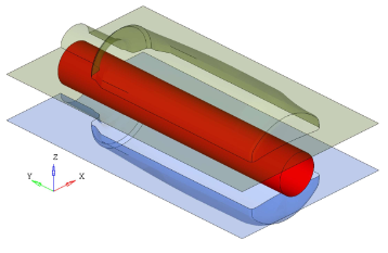

Model Description
Figure 3. Problem Description for Blow Molding
