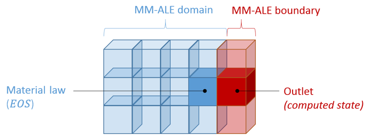

- It is recommended to build boundary layer elements normal to the direction of the modeling flow.
- Outlet element state is computed using initial values and affected quantities from adjacent element.
