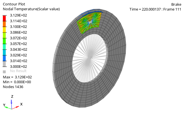

A frictional mechanism is studied, which consists of a brake system, defined by a disc pinched between two pads.
Figure 1. Temperature contour of the brake with friction

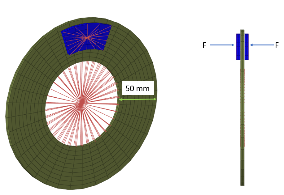

The brake system consists of a disc with a radius of 100 mm, a width of 50 mm, a thickness of 5 mm, and mass = 0.914 kg clamped between two brake pads which are 5 mm thick and weigh 0.06 kg each. The parts are modeled using brick elements using the HEPH (Isolid=24) element formulation.
The disc has an initial rotational velocity of . The initial rotational velocity is defined using the /INIVEL/AXIS keyword. This results in an inertia of 5712.5 kg/mm2. A rigid body is created within the inner diameter of the disc. The main node of this rigid body is the center of the rotation and is constrained in all DOFs, except rotation around Y-axis.
A rigid body is created on the outside face of each brake pad. To simulate braking, a concentrated force of 0.3 kN is applied to the main node of each rigid body attached to the two pads. The pads then contact each side of the disc.
Figure 2. Brake Model

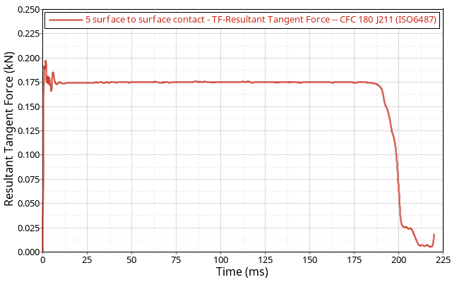

The total normal contact force between the pads and the disc is FN = 0.6 kN and Coulomb friction coefficient= 0.3.

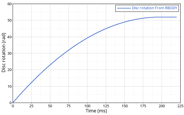

The tangential friction force on the surface of the disc is calculated as FT = 0.3 x FN = 0.18 kN. The orthogonal project from the disc’s center axis to the force application point is r = 77.528 mm. This results in a torque around the axis of the disc of,
T = r x FT = 13.95504 kN*mm
Figure 3. Rotation of the Brake Disc
Figure 4. Resultant Tangent Force Filtered at 180 Hz

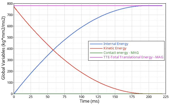

Figure 5. Energy Balance Plot
The total energy in the simulation remains constant. The initial kinetic energy is correctly converted into internal energy at the end of the simulation. Contact energy is numerical only and not physical so it should be a small value in the simulation.
