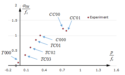

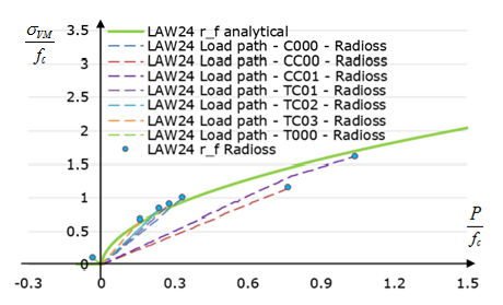

| T000 Uniaxial tension
1/3 |
0.1 |
| C000 Uniaxial compression
-1/3 |
| CC00 Biaxial compression
-2/3 |
1.15 |
| CC01 Compression/Compression
-0.5849 |
1.22 |
| TC01 Compression/Tension
-0.3077 |
0.8 |
| TC02 Compression/Tension
-0.2838 |
0.6 |
| TC03 Compression/Tension
-0.2377 |
0.35 |
