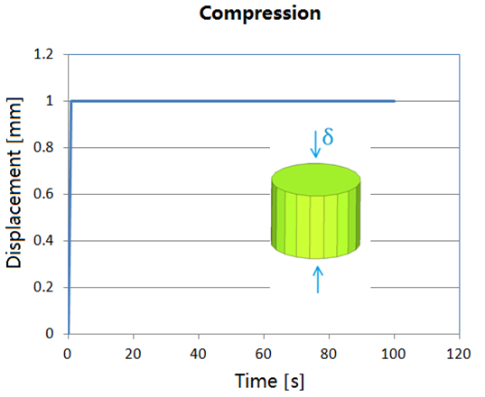

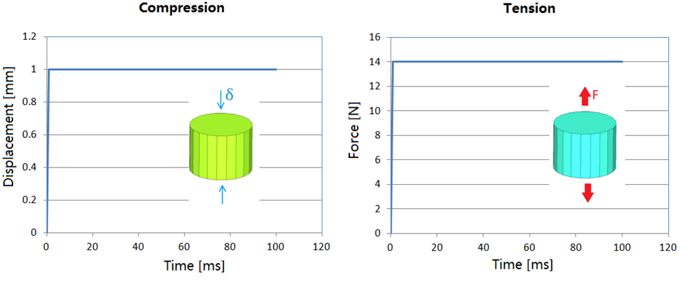

- For stress relaxation test: The foam sample has been compressed until a given strain and kept in this state.
- For creep test: The foam sample has been tensile under constant force.

Figure 3. Stress Relaxation Test under Constant Displacement and Creep Test under Constant Force
For stress relaxation test: The foam sample has been compressed under constant displacement (/IMPDISP).
For creep test: The foam sample has been tensile under constant force (/CLOAD).

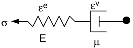

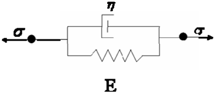

The general case of viscous materials represents time-dependent in elastic behavior. Creep is time-depended deformation and stress relaxation is a time-depended decrease in stress. Viscous material can describe these two phenomenons. In Radioss, the following material laws describe viscous:

Figure 8. Maxwell Model
Figure 9. Kelvin_Voigt Model
