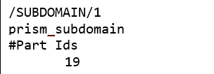

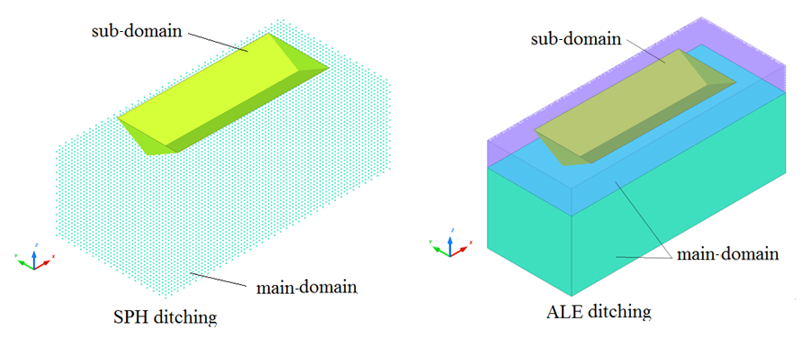

- In the Starter, use /SUBDOMAIN to define a sub-domain. In this example, part ID 19 is defined as a sub-domain.
Figure 1.Note: The subdomain_title “prism_subdomain” is the prefix used in the sub-domain Engine name prism_subdomain_0001.rad.
Figure 2. Domain Description in Multi-Domain Approach - Setup the two Engine files:

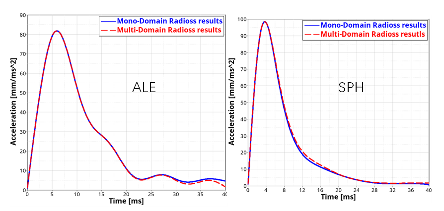

Results
Since the Multi-Domain models used a prism that was deformable, the results cannot be directly compared to the results from RD-E: 2201 ALE and RD-E: 2202 SPH ditching models. Therefore, the Multi-Domain models were rerun as Mono-Domain to obtain results for the comparison.
Figure 3. Comparison between Mono-Domain and Multi-Domain

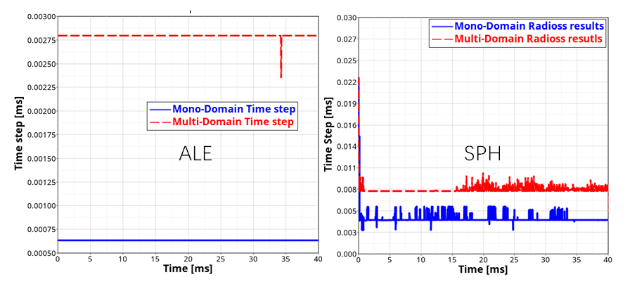

- Time step
Figure 4. Comparison between Mono-Domain and Multi-Domain

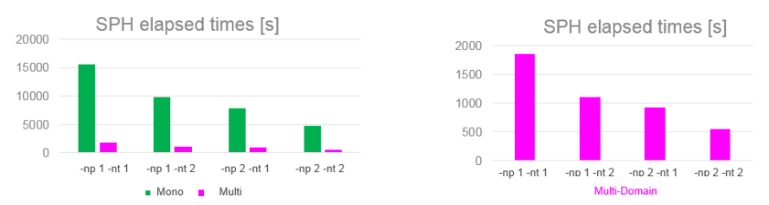

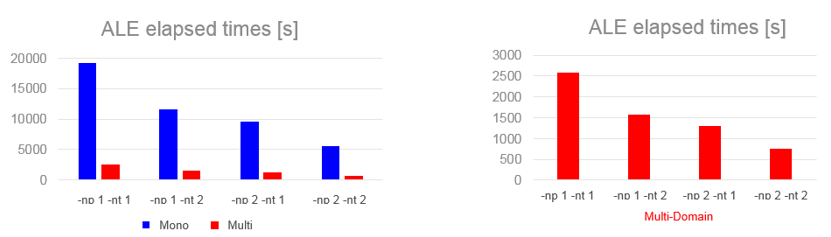

Speedup will then be:(5) - Elapsed times:
Figure 5. ALE Ditching
Figure 6. SPH Ditching
The Multi-Domain FSI speedup ranges from 6 times to 9 times of the Mono-Domain depending on the number of cores used in the simulation.

- For Multi-Domain FSI, it is advised to use have the fluid in the main domain and defined /DT/ALE with an elementary free time step with a scaling factor of 0.5 for ALE. In the Lagrange subdomain, a nodal time step /DT/NODA with a scaling factor of 0.9 should be used.
