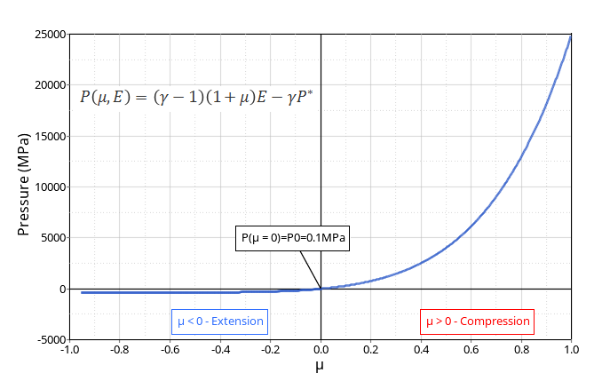

The stiffened gas EOS introduces an
additional pressure term () with respect to the ideal gas equation of state. The EOS is
stated in this form because the speed of sound in water is:(2)
This way, by considering , the speed of sound will not be affected by fluctuations and .
can be calculated with:(3)
As , leads to a good estimate of .
The stiffened gas EOS 1 can be derived from a polynomial EOS:(4)
Where,
For example, for water, , and can be found in literature. 1 This leads to. Thus, the stiffened gas EOS will give the following
behavior at atmospheric pressure: Figure 1.
