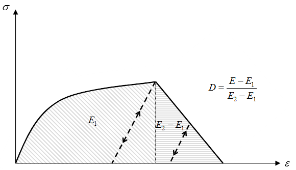

- The element is
deleted, if D=1 for one integration point.
(1) - The energy density is the current internal
energy of the element divided by the current element volume. The value will be different
than the element time history /TH/element Internal energy (IE) which is
the current internal energy divided by the "initial" element volume.
Figure 1. Energy Density Model Failure - The fail_ID is used with /STATE/BRICK/FAIL and /INIBRI/FAIL. There is no default value. If the line is blank, no value will be output for failure model variables in the /INIBRI/FAIL (written in .sta file with /STATE/BRICK/FAIL option).
