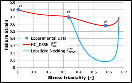

- This failure criterion is defined in
the space of equivalent plastic strain at failure versus stress triaxiality (state of
stress) for plane stress condition. This allows for definition of failure strain that
varies with different loading conditions. It consists of two curves. One is the fracture
locus (that is, below the red curve) and the other is the localized necking locus (blue
curve).
Figure 2.The former takes the following form:(1) , and are functions of the Lode angle :
The latter is defined only between uniaxial and eqi-biaxial tension conditions for ( ) in which localized necking can occur.(2) (3) - The universal exponent of =0.01 is used.
- Localized necking is predicted in a non-local manner when all integration points or layers have > 1.
- The failure curve parameters a, b,
c, and d, must be calibrated based on test
results.
is the triaxiality.
