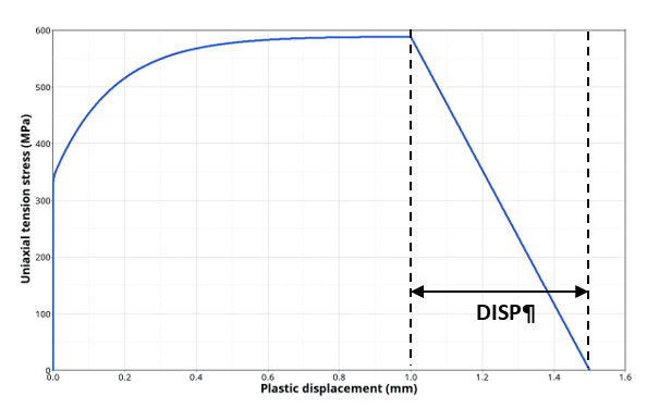

- If EVOSHAP = 1, the damage
evolution is linear:
- If EVOTYPE = 1: plastic
displacement at failure is directly input with
DISP:
(5) Where, is the initial element length.

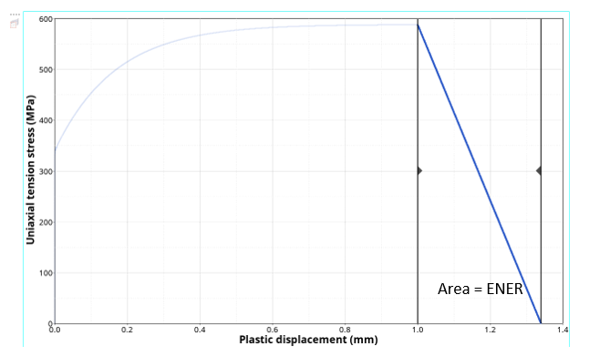

Figure 1. Linear damage evolution with plastic displacement DISP at failure - If EVOTYPE = 2: plastic
displacement at failure is deduced from the fracture energy
input, which is calculated with
ENER:Where, is the yield stress at damage evolution triggering.Note: This expression considers that the plastic behavior is almost perfect at the onset of damage to ensure a dissipated energy equal to .
Figure 2. Linear damage evolution with fracture energy input ENER

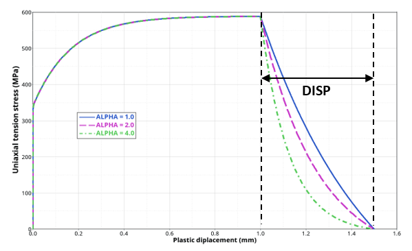

DISP and shape of the exponential can
be modified with ALPHA.
(6)

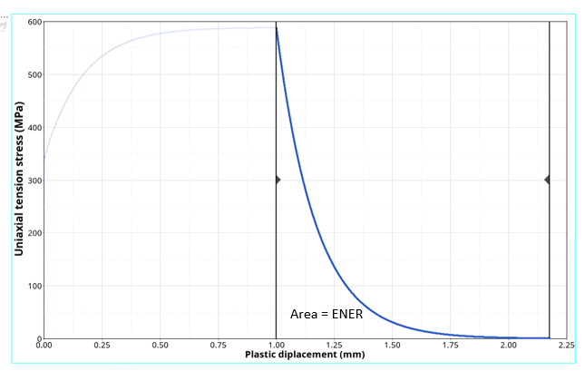

Figure 3. Exponential damage evolution with plastic displacement DISP. at failure with different alpha parameter value - If EVOTYPE = 2: the area
between the stress – plastic displacement curve of the
exponential function corresponds to the failure energy
ENER.
Figure 4. Exponential damage evolution with fracture energy input ENER
