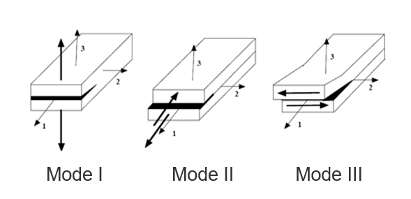

Block Format Keyword Describes the Ladeveze failure model for delamination (interlaminar fracture).
This failure model is available for orthotropic solids and thick shells. It could also be used
with Plyxfem in shell property /PROP/TYPE17 as
an interplay material failure model. This failure model is compatible with /MAT/LAW12 (3D_COMP), /MAT/LAW14 (COMPSO) and /MAT/LAW25 (COMPSH) and /MAT/LAW1 (ELAST) (only when used with
Plyxfem).

Coupling factor between
delamination Mode I and Mode II.
Default = 0 (Real)
delamination Mode I and Mode III.
Default = 0 (Real)
Yield energy damage for
delamination start.
Default = 1030 (Real)
Critical energy damage
parameter for full delamination.
For Quad 2D element, only Mode II
and Mode III are available.
Where, is the internal damage parameters associated
with its fracture mode.
The damage evolution law is controlled by
equivalent damage energy release rate.
with
The evolution of the damage parameters
is strongly coupled with coupling factor and . These two material parameters come from
delamination tests.
For the present failure model, consider that .
