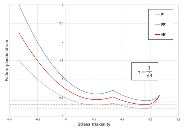

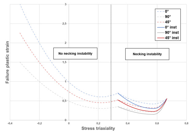

S-Flag Specific behavior flag.
= 1
Two quadratic functions are used.
= 2 (Default)
Plane strain is global minimum.
= 3
Plane strain is global minimum + localized necking.

Inst_start Instability start value for localized necking.
Must be entered, if S-Flag = 3.

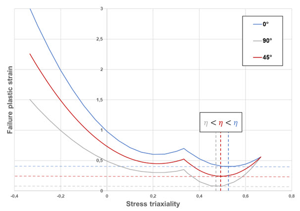

Comments

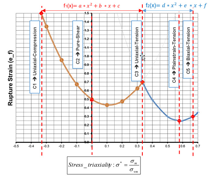

  1. For each input direction, the failure criteria is defined using failure plastic strain versus stress triaxiality (state of stress) as it is the case for the /FAIL/BIQUAD criterion. This allows for the different plastic failure strains that materials exhibit depending on loading condition. The curve is described by 2 parabolic functions that intersect at the triaxiality value of 1 3 MathType@MTEF@5@5@+= feaagKart1ev2aaatCvAUfeBSjuyZL2yd9gzLbvyNv2CaerbuLwBLn hiov2DGi1BTfMBaeXatLxBI9gBaerbd9wDYLwzYbItLDharqqtubsr 4rNCHbGeaGqiVu0Je9sqqrpepC0xbbL8F4rqqrFfpeea0xe9Lq=Jc9 vqaqpepm0xbba9pwe9Q8fs0=yqaqpepae9pg0FirpepeKkFr0xfr=x fr=xb9adbaqaaeGaciGaaiaabeqaamaabaabaaGcbaWaaSaaaeaaca aIXaaabaGaaG4maaaaaaa@377E@ which is uniaxial tension.
    Figure 1. Biquad failure criterion shape
    The parameters for the 2 parabolic failure strain curves versus the state of stress (stress triaxiality) are calculated iteratively by Radioss during the initialization phase using the input c1-c5 values.
    If the calculated parabolic failure strain curves have negative failure strain values, these negative values will be replaced by a failure strain of 1E-6 which results in a very high damage accumulation and brittle behavior.
    This failure criteria is usable for all elasto-plastic material models with shells and solids.

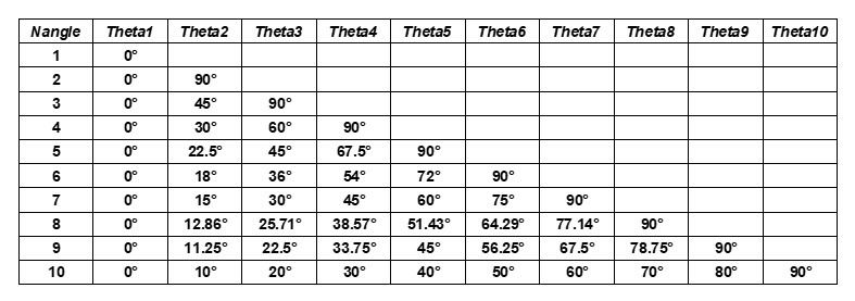

  2. To consider the failure orthotropy, several set of c1, c2, c3, c4 and Inst_start parameters can be given. You can input up to 10 different set of parameters for 10 different experimental loading direction (marked by an angle denoted θ ). The number of input tested loading direction is set by the parameter Nangle. The directions must be equally distributed 0 and 90 degrees following the table.
    Figure 2. Expected input loading direction angle depending on the value of Nangle

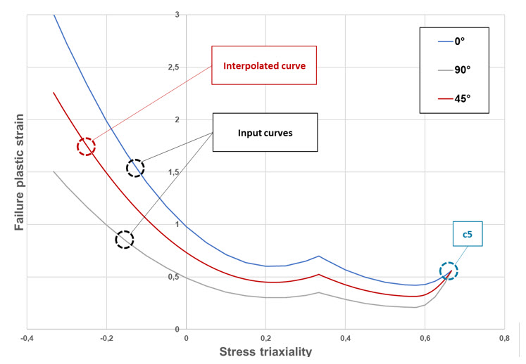

    Loading directions not given in the input are interpolated using Fourier series. All directions have the same plastic strain at failure in biaxial tension.
