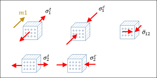

Strength ( , , , , ) are taken from following tests. m1 is fiber direction.
