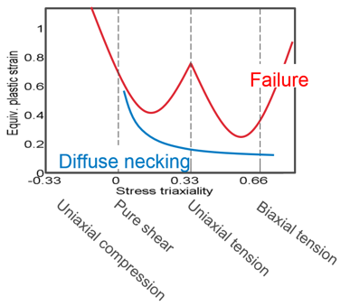

- The plastic failure strain is defined
as:
(1) Where,- Described in table1_ID and is calculated by interpolating between the failure strain versus stress triaxiality functions for strain rate and Lode angle .
- Stress triaxiality
- Hydrostatic stress
- von Mises stress
The first function from table1_ID is used for strain rate values from 0 to its corresponding strain rate. For strain rates above the last defined function, the failure strain value is extrapolated using the last two curves and their corresponding strain rates.
It is possible to consider element size in material failure by function fct_IDel to scale the failure strain depending on the normalized element size with Ch_i_f=1 or 3.(2) Where, is the function of fct_IDel.
Element size scale factor is only applied between triaxiality limits defined by Shrf and Biaxf.(3) Outside this triaxiality range, the element size scaling is not applied to failure or instability curves.Note: If non-local regularization is used (with /NONLOCAL/MAT), the element size scaling factor is not used. If a scaling function is still defined (fct_IDel > 0), the parameters are scaled using LE_MAX parameter of the non-local card (either specified directly by you or computed from the Rlen parameter value).Temperature dependency can be considered in material failure by defining a function to scale the failure strain depending on the normalized temperature:(4) Here, is defined using fct_IDT and Temperature is computed as:(5) It is recommended to use /HEAT/MAT to define the thermal parameter for material laws (which support thermo-plasticity).

- The first variable of
table1_ID is the plastic failure strain versus stress
triaxiality function, the second variable is strain rate and the third is the
Lode angle parameter
(for solids).
For shell, only 2D tables are available (no dependency of Lode angle).
- Instability (diffuse necking):
- Only available for shells
- The fading exponent describes the softening behvior and starts of
instability (diffuse necking). The recommended value of
Fad_exp is 5 to 10.
If Fad_exp < 0 and Ch_i_f=2 or 3, then the absolute value of the fading exponent is a function identifier fct_IDel which defines the fading exponent as a function of element length.
- The start of instability can be described as a function or constant
value:
- table2_ID is a function of instability strain
versus triaxiality where the instability strain defines when
diffuse necking starts. Strain rate dependency for diffuse
necking could be considered as well using
dimension=2 in
/TABLE.
(11) - If table2_ID is not defined,
inst_start is used as constant flat line
for instability starting value over the triaxiality, where the
default value is
Dp.

- The diffuse necking softening is based according to this
equation:
(12) Where, with being the diffuse necking strain.
Currently, diffuse necking (material instability) in /FAIL/TAB1 could be used with material laws greater than 28.
