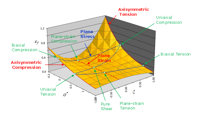

- To use /FAIL/TAB2, it is required to define a
plastic strain at failure used to compute the damage accumulation presented
below. It can be either constant using FCRIT parameter
alone or tabulated if EPSF_ID table identifier is
specified. The tabulated plastic strain at failure is defined with respect
to stress triaxiality, Lode parameter and temperature
(Figure 1). If EPSF_ID is defined, FCRIT becomes a scale factor to quickly increase or decrease the entire plastic strain at failure map.
Figure 1. Tabulated failure criterion map showing the evolution of plastic strain at failure with respect to stress triaxiality and Lode parameter

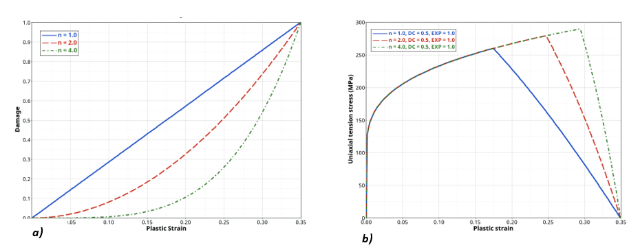

- The damage variable evolution is given by:
(2) The parameter N then allows you to change the shape of the damage evolution with plastic strain shape from linear (N = 1, set by default) to nonlinear (N ≠ 1) (Figure 2(a)). An increase of N also creates a delay of the stress softening effect (Figure 2(b)).
Figure 2. Effect of parameter N on the damage variable evolution and the stress softening effect

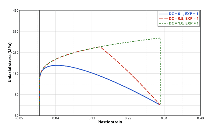

- The DCRIT parameter allows you to define a damage
variable trigger value for stress softening (Figure 3). By default DCRIT
= 0.0, which means that damage variable always has an effect on stress
computation, generating a softening effect from the beginning of the
plasticity. However, you may want to delay this stress softening effect to a
higher value of damage variable (0 < D < 1) or cut the effect of
stress softening to obtain a fully failure criterion approach where elements
lose their load carrying capacity when damage reaches the value 1.
Figure 3. Effect of parameter DCRIT on the stress softening effect

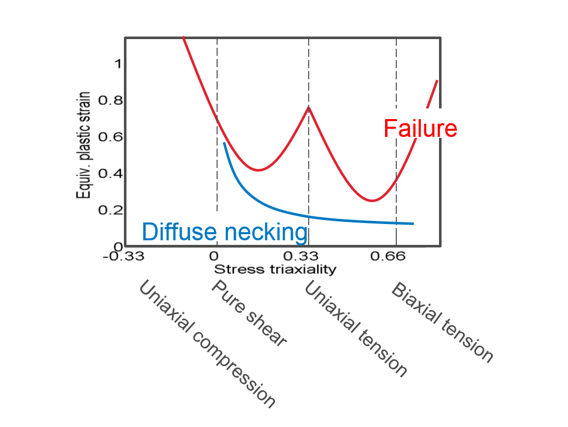

- Instead of using a constant value of DCRIT to
trigger stress softening, a necking control process can be used. This is
defined using the parameter INST_ID and/or
ECRIT. The definition of those parameters will imply
the computation of another variable evolution called instability variable
and denoted
(3) The evolution of this instability variable is similar to the damage variable but represents the criterion to reach to trigger stress softening, implying the start of the strain localization and then necking especially observed at high stress triaxiality. When the criterion is reached ( = 1), the instant value taken by the damage variable D is saved in the value DCRIT, which becomes an element history variable and not a constant value. In this case, the DCRIT value defined in the input card is ignored.
ECRIT allows you to define a constant necking plastic strain. However, the necking plastic strain can be defined with a table INST_ID depending on stress triaxiality, Lode parameter and temperature. In this case, ECRIT becomes a scale factor for the instability plastic strain table. The instability plastic strain must be lower than failure plastic strain to have a visible effect (Figure 4).Figure 4. Necking plastic strain curve (blue) and failure plastic strain curve (red)

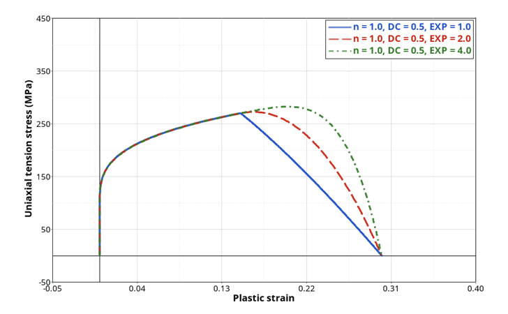

- Even if the shape of the damage accumulation can be controlled with
parameter N, another non-linearity in stress softening
can be defined with the exponent EXP (Figure 5). This exponent can be constant if
EXP parameter is defined alone or can evolve with
element size if FCT_EXP is specified. If the function is
used, EXP_REF is the element reference size and
EXP becomes a scale factor. By default,
EXP is set to 1.0 leading to a linear decrease.
Figure 5. Effect of exponent parameter EXP on the stress softening shape
