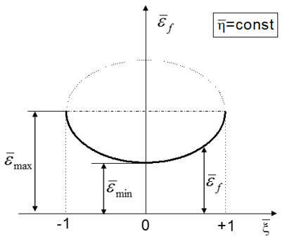

Comments
- For
which is used in failure flag is:
(1)
Figure 1.Where,
For Brick:- If Imoy = 0
- If Imoy = 1
For Shell:- ;
Where,- Hydrostatic stress
- von Mises stress
- Third invariant deviatoric stress
