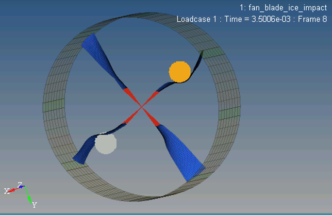

Figure 3. Initial Impact, t=3.5e-3

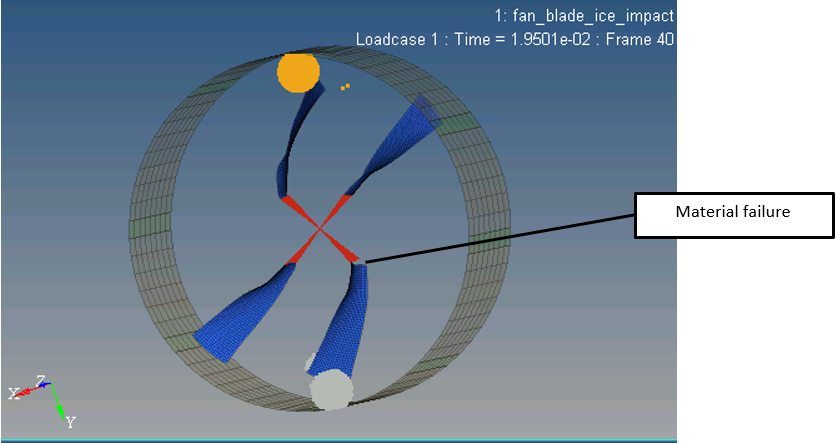

Figure 4. Blade Material Failure
Figure 5. Blade Failure and Case Impact
