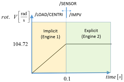

The centrifugal force field is applied to the blades using the /LOAD/CENTRI option with a linear ramp function with a maximum value of 104.72 . Since you want to obtain a steady-state rotation condition, use /LOAD/CENTRI option Ivar=1, the variation of velocity is not taken into account.
When the second Engine file starts, an initial and constant imposed rotational velocity of 104.72 is applied to the blades. The imposed velocity (/IMPVEL) is activated using a time activated sensor (/SENSOR/TIME) at t=0.1 seconds. A sensor TYPE=NOT (/SENSOR/NOT) is used to turn off the centrifugal force when the imposed velocity is turned on. The /SENSOR/NOT activation state is opposite of the sensor it references and; thus, it will be on from time = 0 – 0.1 seconds.
Figure 1.To keep the implicit solution in static equilibrium, a fully-constrained boundary condition (/BCS) is used on the main node of the rigid body that connects the base nodes of the blades. This fully-constrained boundary condition is removed in a second Engine file when rotation begins.

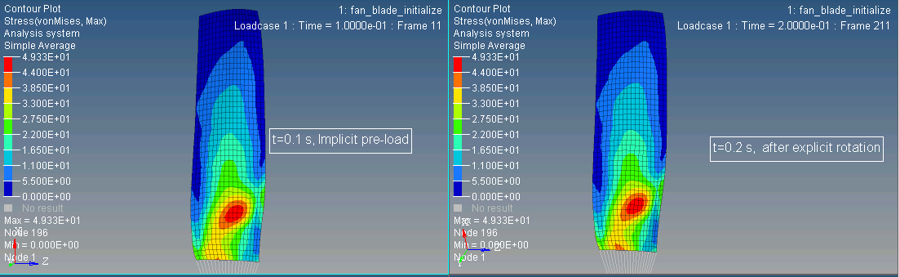

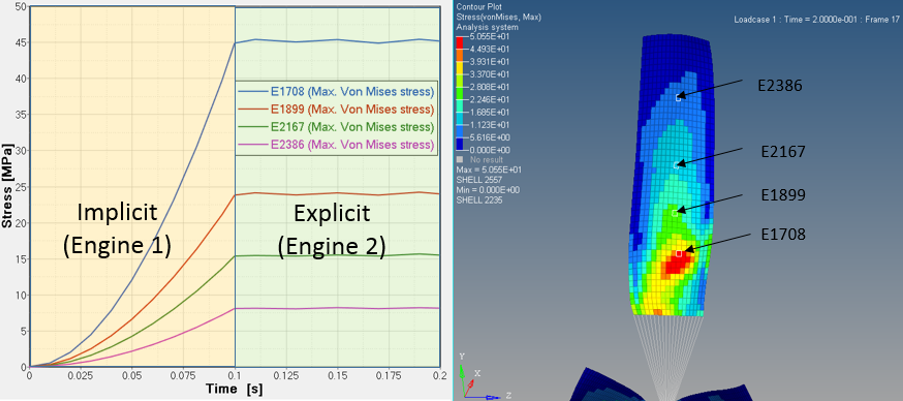

The purpose of the analysis is to initialize the centrifugal force field and stress on the blades from a 1000 RPM rotation. One method to initialize the centrifugal force would be to slowly increase to rotational speed from 0 to 1000 RPM. However, for explicit simulations this can be very time consuming. To reduce the simulation time, the implicit solution method and the /LOAD/CENTRI option in Radioss can be used to create the centrifugal force field. Using a second Engine file, an initial rotational velocity is applied to the blades and a /SENSOR is used to turn off the centrifugal force field and turn on an imposed velocity, (/IMPVEL). Now that the blades are rotating, the stress remains constant which means the blades are in steady-state rotation.
Results
Figure 3. Comparison of Stress after Centrifugal Load in Implicit and Explicit Rotation
Figure 4. Time History Plot of Element Stress
