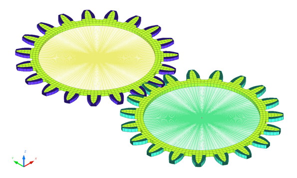

Figure 2. Global View of the Mesh

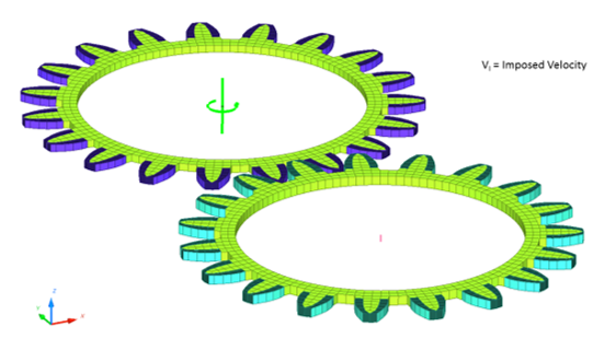

Figure 3. Imposed Velocity on the Rigid Body Main Node

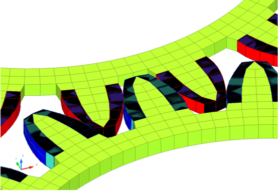

Figure 4. View of the Teeth

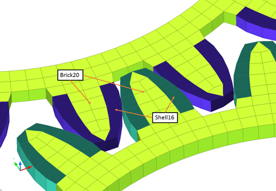

Figure 5. Contact Modeling between Quadratic Surfaces (TYPE 16/17 Interfaces)

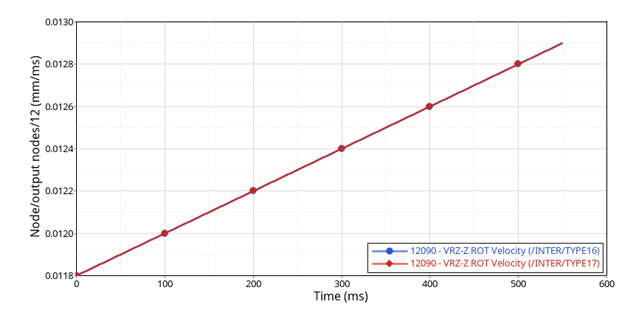

Figure 6. Imposed Rotational Velocity Curves
Conclusion
Both interfaces provide overall satisfactory results for this kind of application where the contact surfaces are complex and there is no gap. Since these contacts use Lagrange multiplier kinematical conditions, they only work with SMP parallelization which is limited to fewer CPUs compared to Hybrid and SPMD parallelization. For larger models, penalty contacts TYPE24 and TYPE25 work better for solid elements with no contact gap.
