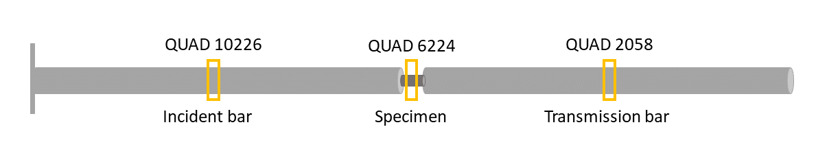

True Stress, True Strain and True Strain Rate Measurement from Time History
rad_ex_fig_8-6

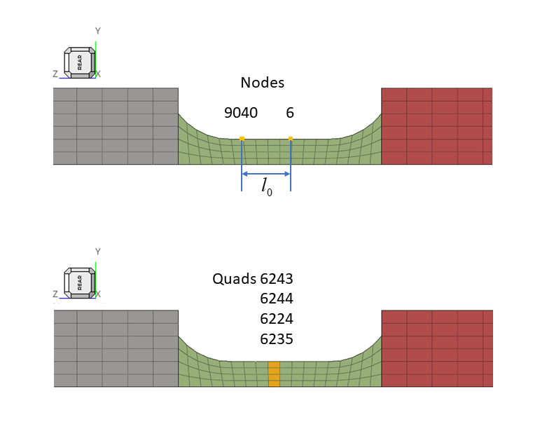

Figure 2. Nodes and quads saved for time history

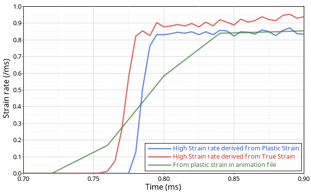

In the experiment, the strain gauge is attached to the specimen. In simulation, the true strain will be determined from 9040 and 6 nodes’ relative Z displacements ( l 0 = 3.83638 mm).
The true stress can be given using two data sources. The first methodology consists of using the equation previously presented, based on the assumption of the one-dimensional propagation of bar-specimen forces. The engineering strain ε t associated with the output stress wave is obtained from the Z displacement of nodes located on the output bar. The true plastic strain is extracted from the quads on the specimen, saved in the Time Histories file. True stress can also be measured directly from the Time History using the average of the Z stress quads 6243, 6244, 6224 and 6235. It should be noted that the section option is not available for quad elements.
The strain rate can be calculated from either the true plastic strain of quads saved in /TH/QUAD or from the true strain ε true .

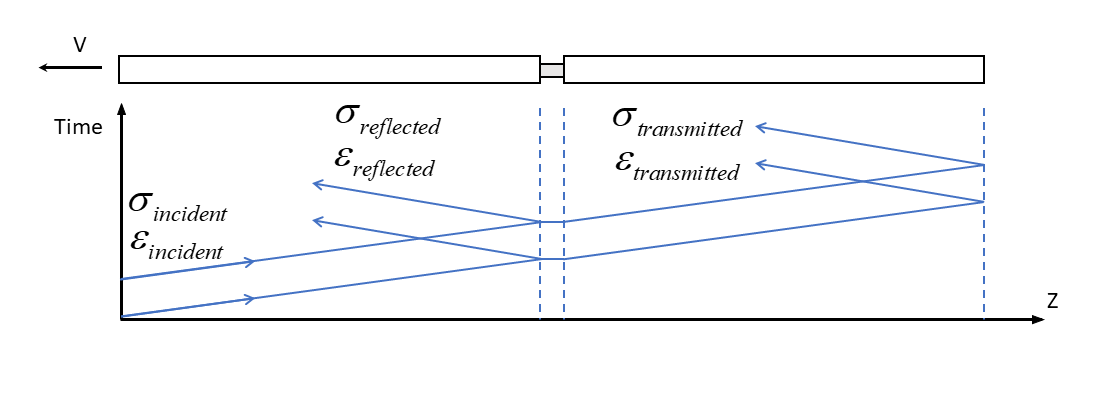

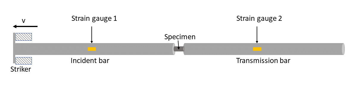

The Split-Hopkinson pressure bar is a suitable method to perform experiments with high strain rates.
Figure 3 shows the principal test setup, consisting of:
  • an incident bar and a transmission bar of equal length, between which the sample to be tested is clamped.
  • a striker is attached to the outer end of the incident bar. When a steel projectile hits the striker, a stress pulse is introduced into the incident bar.
rad_ex_fig_8-1
Figure 3. Split-Hopkinson pressure bar device
The impact generates a strain (tensile) wave which propagates through (along) the Incident bar and is detected by strain gauge 1. Part of the wave is reflected, and a part is transmitted via the specimen’s interface. So, the stress pulse continues through the specimen and into the transmitted bar. Strain gauges 1 and 2 are attached to the incident bar and transmission bar to detect the strain wave signal. The wave reflections inside the sample enable the stress to be homogenized during the test. The strain associated with the output or transmitted stress wave is measured by the strain gauges on the output or transmitted bar. The strain gauges attached to the specimen gauge length provide direct measuring of the true strain and the true plastic strain in the specimen during the experiment. The transmitted elastic wave provides a direct force measurement to the bar specimen interfaces by way of the following relation.

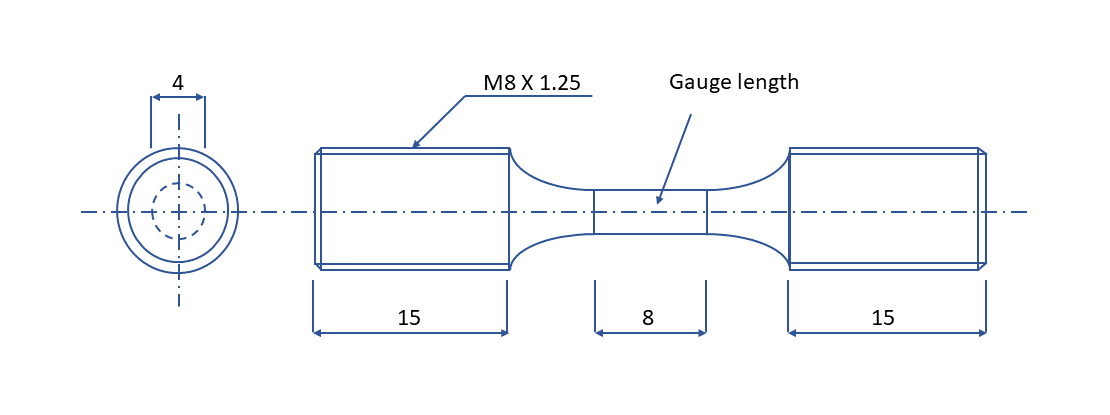

rad_ex_fig_8-2
Figure 4. Specimen geometry and cross-section (dimensions in mm)

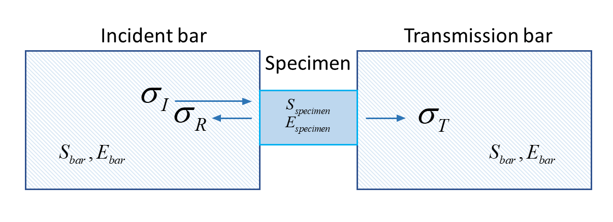

If the two bars remain elastic and wave dispersion is ignored, then the measured stress pulses can be assumed to be the same as those acting on the specimen.
The engineering stress value in the specimen can be determined by the wave analysis, using the transmitted wave:(2) σ engineering ( t )= F( t ) S specimen = S bar E bar S specimen ε T ( t ) MathType@MTEF@5@5@+= feaagKart1ev2aqatCvAUfeBSjuyZL2yd9gzLbvyNv2CaerbuLwBLn hiov2DGi1BTfMBaeXatLxBI9gBaerbd9wDYLwzYbItLDharqqtubsr 4rNCHbGeaGqiVu0Je9sqqrpepC0xbbL8F4rqGqFfpeea0xe9vq=Jb9 vqpeea0xd9q8qiYRWxGi6xij=hbba9q8aq0=yq=He9q8qiLsFr0=vr 0=vr0db8meaabaqaciGacaGaaeqabaWaaeaaeaaakeaacqaHdpWCda WgaaWcbaGaamyzaiaad6gacaWGNbGaamyAaiaad6gacaWGLbGaamyz aiaadkhacaWGPbGaamOBaiaadEgaaeqaaOWaaeWaaeaacaWG0baaca GLOaGaayzkaaGaeyypa0ZaaSaaaeaacaWGgbWaaeWaaeaacaWG0baa caGLOaGaayzkaaaabaGaam4uamaaBaaaleaacaWGZbGaamiCaiaadw gacaWGJbGaamyAaiaad2gacaWGLbGaamOBaaqabaaaaOGaeyypa0Za aSaaaeaacaWGtbWaaSbaaSqaaiaadkgacaWGHbGaamOCaaqabaGcca WGfbWaaSbaaSqaaiaadkgacaWGHbGaamOCaaqabaaakeaacaWGtbWa aSbaaSqaaiaadohacaWGWbGaamyzaiaadogacaWGPbGaamyBaiaadw gacaWGUbaabeaaaaGccqaH1oqzdaWgaaWcbaGaamivaaqabaGcdaqa daqaaiaadshaaiaawIcacaGLPaaaaaa@6980@
Engineering stress can also be found by averaging out the force applied by the incident that is the reflected and transmitted wave, as shown in the equation:(3) σ engineering ( t )= S bar E bar 2 S specimen [ ε l ( t )+ ε R ( t )+ ε T ( t ) ] MathType@MTEF@5@5@+= feaagKart1ev2aqatCvAUfeBSjuyZL2yd9gzLbvyNv2CaerbuLwBLn hiov2DGi1BTfMBaeXatLxBI9gBaerbd9wDYLwzYbItLDharqqtubsr 4rNCHbGeaGqiVu0Je9sqqrpepC0xbbL8F4rqGqFfpeea0xe9vq=Jb9 vqpeea0xd9q8qiYRWxGi6xij=hbba9q8aq0=yq=He9q8qiLsFr0=vr 0=vr0db8meaabaqaciGacaGaaeqabaWaaeaaeaaakeaacqaHdpWCda WgaaWcbaGaamyzaiaad6gacaWGNbGaamyAaiaad6gacaWGLbGaamyz aiaadkhacaWGPbGaamOBaiaadEgaaeqaaOWaaeWaaeaacaWG0baaca GLOaGaayzkaaGaeyypa0ZaaSaaaeaacaWGtbWaaSbaaSqaaiaadkga caWGHbGaamOCaaqabaGccaWGfbWaaSbaaSqaaiaadkgacaWGHbGaam OCaaqabaaakeaacaaIYaGaam4uamaaBaaaleaacaWGZbGaamiCaiaa dwgacaWGJbGaamyAaiaad2gacaWGLbGaamOBaaqabaaaaOWaamWaae aacqaH1oqzdaWgaaWcbaGaamiBaaqabaGcdaqadaqaaiaadshaaiaa wIcacaGLPaaacqGHRaWkcqaH1oqzdaWgaaWcbaGaamOuaaqabaGcda qadaqaaiaadshaaiaawIcacaGLPaaacqGHRaWkcqaH1oqzdaWgaaWc baGaamivaaqabaGcdaqadaqaaiaadshaaiaawIcacaGLPaaaaiaawU facaGLDbaaaaa@6B8B@
Where,
ε I and ε R
Strains associated with input stress wave.
ε T
Strain associated with output stress wave.
True stress in the specimen is computed using the following relation (refer to Example 11 - Tensile Test for further details):(4) σ t r u e = σ e n g i n e e r i n g exp ( ε t r u e )
The true strain rate is given by:(5) ε ˙ = Δ ε t r u e Δ t
True stress and true strain are evaluated up to the failure point.
rad_ex_fig_8-4
Figure 5. 1D analysis
Interface 1
F 1 = S bar [ σ l ( t )+ σ R ( t ) ]= S bar E bar [ ε l ( t )+ ε R ( t ) ] MathType@MTEF@5@5@+= feaagKart1ev2aqatCvAUfeBSjuyZL2yd9gzLbvyNv2CaerbuLwBLn hiov2DGi1BTfMBaeXatLxBI9gBaerbd9wDYLwzYbItLDharqqtubsr 4rNCHbGeaGqiVu0Je9sqqrpepC0xbbL8F4rqGqFfpeea0xe9vq=Jb9 vqpeea0xd9q8qiYRWxGi6xij=hbba9q8aq0=yq=He9q8qiLsFr0=vr 0=vr0db8meaabaqaciGacaGaaeqabaWaaeaaeaaakeaacaWGgbWaaS baaSqaaiaaigdaaeqaaOGaeyypa0Jaam4uamaaBaaaleaacaWGIbGa amyyaiaadkhaaeqaaOWaamWaaeaacqaHdpWCdaWgaaWcbaGaamiBaa qabaGcdaqadaqaaiaadshaaiaawIcacaGLPaaacqGHRaWkcqaHdpWC daWgaaWcbaGaamOuaaqabaGcdaqadaqaaiaadshaaiaawIcacaGLPa aaaiaawUfacaGLDbaacqGH9aqpcaWGtbWaaSbaaSqaaiaadkgacaWG HbGaamOCaaqabaGccqGHflY1caWGfbWaaSbaaSqaaiaadkgacaWGHb GaamOCaaqabaGcdaWadaqaaiabew7aLnaaBaaaleaacaWGSbaabeaa kmaabmaabaGaamiDaaGaayjkaiaawMcaaiabgUcaRiabew7aLnaaBa aaleaacaWGsbaabeaakmaabmaabaGaamiDaaGaayjkaiaawMcaaaGa ay5waiaaw2faaaaa@63CE@
Interface 2
F 2 = S bar σ T ( t )= S bar E bar ε T ( t ) MathType@MTEF@5@5@+= feaagKart1ev2aqatCvAUfeBSjuyZL2yd9gzLbvyNv2CaerbuLwBLn hiov2DGi1BTfMBaeXatLxBI9gBaerbd9wDYLwzYbItLDharqqtubsr 4rNCHbGeaGqiVu0Je9sqqrpepC0xbbL8F4rqGqFfpeea0xe9vq=Jb9 vqpeea0xd9q8qiYRWxGi6xij=hbba9q8aq0=yq=He9q8qiLsFr0=vr 0=vr0db8meaabaqaciGacaGaaeqabaWaaeaaeaaakeaacaWGgbWaaS baaSqaaiaaikdaaeqaaOGaeyypa0Jaam4uamaaBaaaleaacaWGIbGa amyyaiaadkhaaeqaaOGaeyyXICTaeq4Wdm3aaSbaaSqaaiaadsfaae qaaOWaaeWaaeaacaWG0baacaGLOaGaayzkaaGaeyypa0Jaam4uamaa BaaaleaacaWGIbGaamyyaiaadkhaaeqaaOGaeyyXICTaamyramaaBa aaleaacaWGIbGaamyyaiaadkhaaeqaaOGaeyyXICTaeqyTdu2aaSba aSqaaiaadsfaaeqaaOWaaeWaaeaacaWG0baacaGLOaGaayzkaaaaaa@5803@
Balance in specimen
F 1 = F 2 MathType@MTEF@5@5@+= feaagKart1ev2aqatCvAUfeBSjuyZL2yd9gzLbvyNv2CaerbuLwBLn hiov2DGi1BTfMBaeXatLxBI9gBaerbd9wDYLwzYbItLDharqqtubsr 4rNCHbGeaGqiVu0Je9sqqrpepC0xbbL8F4rqGqFfpeea0xe9vq=Jb9 vqpeea0xd9q8qiYRWxGi6xij=hbba9q8aq0=yq=He9q8qiLsFr0=vr 0=vr0db8meaabaqaciGacaGaaeqabaWaaeaaeaaakeaacaWGgbWaaS baaSqaaiaaigdaaeqaaOGaeyypa0JaamOramaaBaaaleaacaaIYaaa beaaaaa@3BDD@ ; ε l ( t ) + ε R ( t ) = ε T ( t ) MathType@MTEF@5@5@+= feaagKart1ev2aqatCvAUfeBSjuyZL2yd9gzLbvyNv2CaerbuLwBLn hiov2DGi1BTfMBaeXatLxBI9gBaerbd9wDYLwzYbItLDharqqtubsr 4rNCHbGeaGqiVu0Je9sqqrpepC0xbbL8F4rqGqFfpeea0xe9vq=Jb9 vqpeea0xd9q8qiYRWxGi6xij=hbba9q8aq0=yq=He9q8qiLsFr0=vr 0=vr0db8meaabaqaciGacaGaaeqabaWaaeaaeaaakeaacqaH1oqzda WgaaWcbaGaamiBaaqabaGcdaqadaqaaiaadshaaiaawIcacaGLPaaa cqGHRaWkcqaH1oqzdaWgaaWcbaGaamOuaaqabaGcdaqadaqaaiaads haaiaawIcacaGLPaaacqGH9aqpcqaH1oqzdaWgaaWcbaGaamivaaqa baGcdaqadaqaaiaadshaaiaawIcacaGLPaaaaaa@490E@
Engineering stress in specimen
σ specimen ( t )= F 1 S specimen = F 2 S specimen MathType@MTEF@5@5@+= feaagKart1ev2aqatCvAUfeBSjuyZL2yd9gzLbvyNv2CaerbuLwBLn hiov2DGi1BTfMBaeXatLxBI9gBaerbd9wDYLwzYbItLDharqqtubsr 4rNCHbGeaGqiVu0Je9sqqrpepC0xbbL8F4rqGqFfpeea0xe9vq=Jb9 vqpeea0xd9q8qiYRWxGi6xij=hbba9q8aq0=yq=He9q8qiLsFr0=vr 0=vr0db8meaabaqaciGacaGaaeqabaWaaeaaeaaakeaacqaHdpWCda WgaaWcbaGaam4CaiaadchacaWGLbGaam4yaiaadMgacaWGTbGaamyz aiaad6gaaeqaaOWaaeWaaeaacaWG0baacaGLOaGaayzkaaGaeyypa0 ZaaSaaaeaacaWGgbWaaSbaaSqaaiaaigdaaeqaaaGcbaGaam4uamaa BaaaleaacaWGZbGaamiCaiaadwgacaWGJbGaamyAaiaad2gacaWGLb GaamOBaaqabaaaaOGaeyypa0ZaaSaaaeaacaWGgbWaaSbaaSqaaiaa ikdaaeqaaaGcbaGaam4uamaaBaaaleaacaWGZbGaamiCaiaadwgaca WGJbGaamyAaiaad2gacaWGLbGaamOBaaqabaaaaaaa@5A0E@

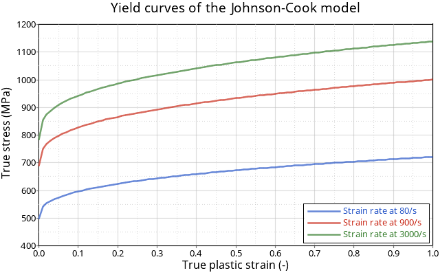

In the documents entitled CRAHVI, G4RD-CT-2000-00395, D.1.1.1, Material Tests – Tensile properties of Aluminum Alloys 7010T7651 and AU4G Over a Range of Strain Rates, the behavior of the 7010 aluminum alloy can be described according to the relations:
σ = ( 496 + 225 ε 0.35 ) MathType@MTEF@5@5@+= feaagKart1ev2aaatCvAUfeBSjuyZL2yd9gzLbvyNv2CaerbwvMCKf MBHbqefqvATv2CG4uz3bIuV1wyUbqedmvETj2BSbqefm0B1jxALjhi ov2DaebbnrfifHhDYfgasaacH8srps0lbbf9q8WrFfeuY=Hhbbf9v8 qqaqFr0xc9pk0xbba9q8WqFfea0=yr0RYxir=Jbba9q8aq0=yq=He9 q8qqQ8frFve9Fve9Ff0dmeaacaGacmGadaWaaiqacaabaiaafaaake aacqaHdpWCcqGH9aqpdaqadaqaaiaaisdacaaI5aGaaGOnaiabgUca RiaaikdacaaIYaGaaGynaiabew7aLnaaCaaaleqabaGaaGimaiaac6 cacaaIZaGaaGynaaaaaOGaayjkaiaawMcaaaaa@4749@
Strain rates below 80 s-1
σ = ( 496 + 225 ε 0.35 ) ( 1 + 0.16 ln ( ε ˙ 0.08 ) ) MathType@MTEF@5@5@+= feaagKart1ev2aaatCvAUfeBSjuyZL2yd9gzLbvyNv2CaerbwvMCKf MBHbqefqvATv2CG4uz3bIuV1wyUbqedmvETj2BSbqefm0B1jxALjhi ov2DaebbnrfifHhDYfgasaacH8srps0lbbf9q8WrFfeuY=Hhbbf9v8 qqaqFr0xc9pk0xbba9q8WqFfea0=yr0RYxir=Jbba9q8aq0=yq=He9 q8qqQ8frFve9Fve9Ff0dmeaacaGacmGadaWaaiqacaabaiaafaaake aacqaHdpWCcqGH9aqpdaqadaqaaiaaisdacaaI5aGaaGOnaiabgUca RiaaikdacaaIYaGaaGynaiabew7aLnaaCaaaleqabaGaaGimaiaac6 cacaaIZaGaaGynaaaaaOGaayjkaiaawMcaamaabmaabaGaaGymaiab gUcaRiaaicdacaGGUaGaaGymaiaaiAdaciGGSbGaaiOBamaabmaaba WaaSaaaeaacuaH1oqzgaGaaaqaaiaaicdacaGGUaGaaGimaiaaiIda aaaacaGLOaGaayzkaaaacaGLOaGaayzkaaaaaa@556B@
Strain rates exceeding 80 s-1 up to 3000 s-1
rad_ex_fig_8-3
Figure 6. Yield curve of the Johnson-Cook model: σ = ( 496 + 225 ε 0.35 ) MathType@MTEF@5@5@+= feaagKart1ev2aaatCvAUfeBSjuyZL2yd9gzLbvyNv2CaerbwvMCKf MBHbqefqvATv2CG4uz3bIuV1wyUbqedmvETj2BSbqefm0B1jxALjhi ov2DaebbnrfifHhDYfgasaacH8srps0lbbf9q8WrFfeuY=Hhbbf9v8 qqaqFr0xc9pk0xbba9q8WqFfea0=yr0RYxir=Jbba9q8aq0=yq=He9 q8qqQ8frFve9Fve9Ff0dmeaacaGacmGadaWaaiqacaabaiaafaaake aacqaHdpWCcqGH9aqpdaqadaqaaiaaisdacaaI5aGaaGOnaiabgUca RiaaikdacaaIYaGaaGynaiabew7aLnaaCaaaleqabaGaaGimaiaac6 cacaaIZaGaaGynaaaaaOGaayjkaiaawMcaaaaa@4749@

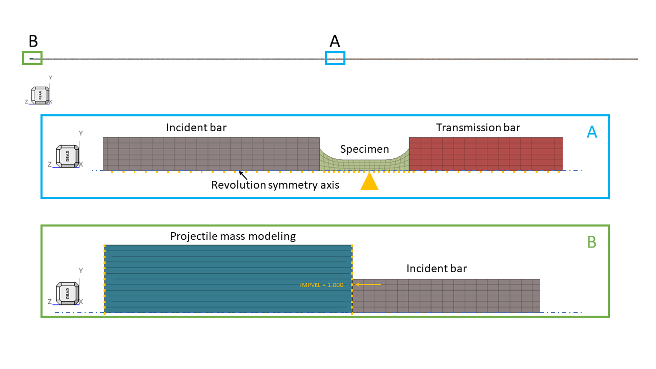

Considering the geometry’s revolution symmetry the material and the kinematic conditions, an axisymmetric model is used (N2D3D = 1 in /ANALY set up in the Starter file). Y is the radial direction and Z is the axis of revolution.
The mesh is made of 12054 2D solid elements (quads). The quad dimension is about 2 mm.
rad_ex_fig_8-5
Figure 7. Axisymmetrical model mesh. with imposed velocities on the top of the input bar

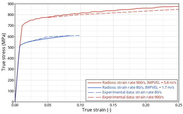

Experimental results show that the variation of the true tensile flow stress compared with the true strain is approximately equivalent to a strain rate between 80 s-1 and 100 s-1. The reference strain, ε R MathType@MTEF@5@5@+= feaagKart1ev2aqatCvAUfeBSjuyZL2yd9gzLbvyNv2CaerbuLwBLn hiov2DGi1BTfMBaeXatLxBI9gBaerbd9wDYLwzYbItLDharqqtubsr 4rNCHbGeaGqiVu0Je9sqqrpepC0xbbL8F4rqGqFfpeea0xe9vq=Jb9 vqpeea0xd9q8qiYRWxGi6xij=hbba9q8aq0=yq=He9q8qiLsFr0=vr 0=vr0db8meaabaqaciGacaGaaeqabaWaaeaaeaaakeaacqaH1oqzda WgaaWcbaGaamOuaaqabaaaaa@3A12@ in the Johnson-Cook model is set to 0.08 ms-1 (correspond to 80 s-1, which represents the quasi-static deformation rate. At higher deformation rates, the true flow stress increases significantly with increasing strain rates. The 7010 aluminum alloy exhibits an increase in the flow stress by a typical value of 30% at high strain rates (900 s-1 – 3000 s-1) compared to the quasi-static value.
Results are given at the specific true strains of 0.02, 0.05 and 0.10. The influence of the strain rate on the stress can be seen in Figure 8. 1
ex8_fig11
Figure 8. Variation of true stress compared with true strain for 7010 alloy. using 2 different rates (experimental data)
For the test performed with a strain rate of 900 s-1, the flow stress reaches 850 [ MPa ] MathType@MTEF@5@5@+= feaagKart1ev2aqatCvAUfeBSjuyZL2yd9gzLbvyNv2CaerbuLwBLn hiov2DGi1BTfMBaeXatLxBI9gBaerbd9wDYLwzYbItLDharqqtubsr 4rNCHbGeaGqiVu0Je9sqqrpepC0xbbL8F4rqGqFfpeea0xe9vq=Jb9 vqpeea0xd9q8qiYRWxGi6xij=hbba9q8aq0=yq=He9q8qiLsFr0=vr 0=vr0db8meaabaqaciGacaGaaeqabaWaaeaaeaaakeaadaWadaqaai Gac2eacaGGqbGaaiyyaaGaay5waiaaw2faaaaa@3BE6@ at a 0.25 strain.

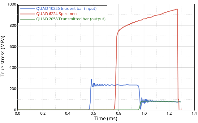

Figure 9 shows the variation of true stress in time in relation to the wave propagation along the bars. Stresses are evaluated on the input bar, the specimen and the transmission bar.
rad_ex_fig_8-8
Figure 9. Stress measurement localizations
rad_ex_fig_8-9

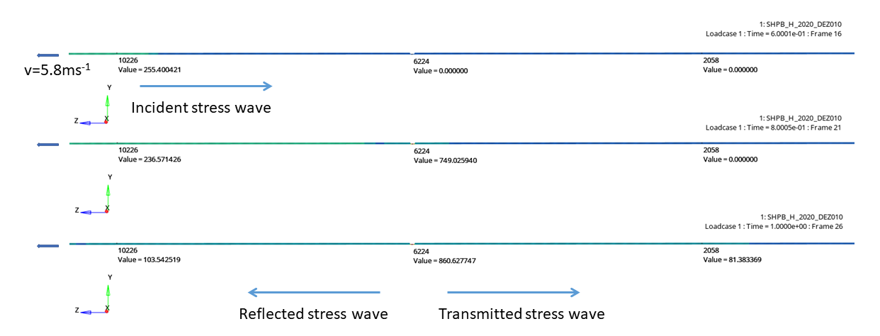

Figure 10. Stress waves in the input bar, the output bar and the specimen. (imposed velocities = 5.8 ms-1)
The stress-time curve shows the incident, reflected and transmitted signals.
rad_ex_fig_8-10
Figure 11. SHPB of the motion in time of the tensile pulse
rad_ex_fig_8-11
Figure 12. von Mises stress wave propagation along bars. (imposed velocities = 5.8 ms-1)

Figure 13 shows the true stress and true strain as a function of the strain rate.
rad_ex_fig_8-12
Figure 13. Variation of true stress with true strain for high and medium strain rates

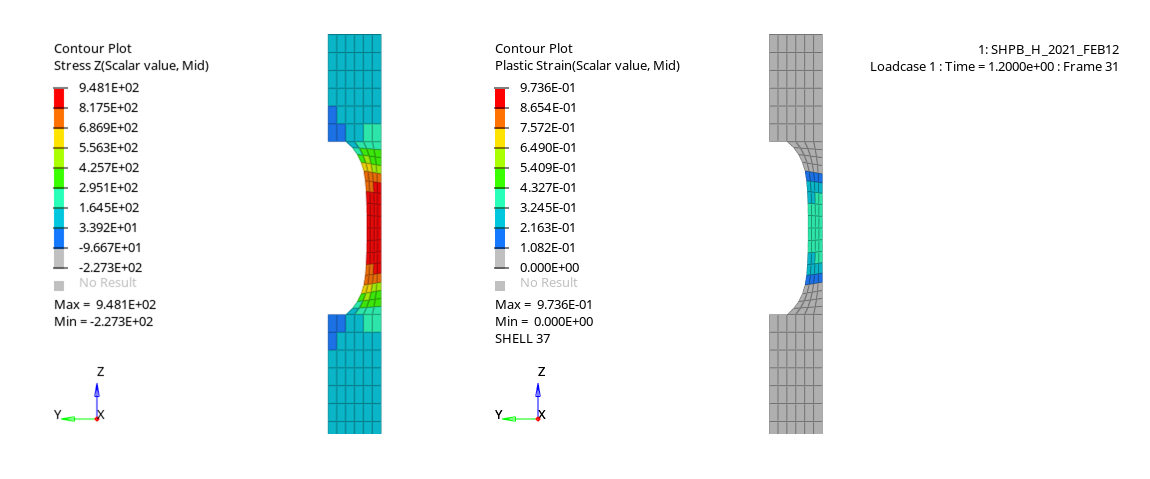

At a high strain rate (900/s), an increase in the flow stress is observed, being approximately 30% higher than the stress obtained for a low strain rate (80/s). The Johnson-Cook model used provides precise results compared with the experimental data.
ex_8_stressZ
Figure 14. Stress Z and plastic strain on specimen at 1.2 ms

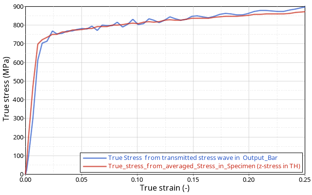

The true stresses determined from both methodologies are shown side-by-side. This validates the analysis based on a transmitted wave. Typical curves for a model having imposed velocities equal to 5.8 ms-1 (Figure 15 and Figure 16).
rad_ex_8_truestress
Figure 15. True stress comparison in the specimen
rad_ex_8_strainrate
Figure 16. True strain rate in the specimen
Either data sources used to evaluate the strain rate give similar results.

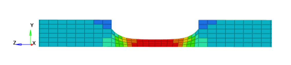

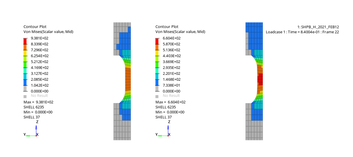

Figure 19 compares the distribution of the von Mises stress on the specimen, with and without the strain rate filtering at time t=0.88 ms.
rad_ex_fig_8-14
Figure 19. Left: strain rate filtering active (cut-off frequency = 1 kHz); Right: no strain rate filtering
More physical flow stress distribution is obtained using filtering. Explicit is an element-by-element method, while the local treatment of temporal oscillations puts spatial oscillations into the mesh.
