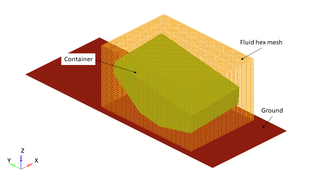

A hex mesh is created that fully encloses the structural container. The mesh size of the hex mesh should be ½ the size of the structural mesh. Ideally the hex mesh should also be ¼ of the structural mesh size in the direction of impact. To simplify this example, the hex mesh in this model does not adhere to the ¼ mesh size guideline.
A container partially filled with water is simulated being dropped from a height of 1 meter. The container is partially filled with water with the remainder filled with air.
ex_50_container
Figure 1. Problem Description

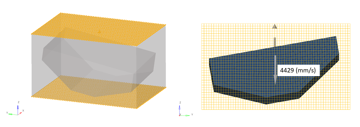

Each outer side of the hex mesh is constrained to prevent displacement in the direction normal to the side. For example, the top and bottom of the hex mesh is constrained in the z translation DOF (Figure 2). The same is done for the other four sides. The velocity at impact of a drop from 1 meter would be 4429 mm/s. Since the simulation is started right before impact, an initial velocity of 4429 mm/s is applied to the container and the fluid hex mesh (Figure 2).
ex_50_container_bc
Figure 2. Boundary Condition of Container in z-direction

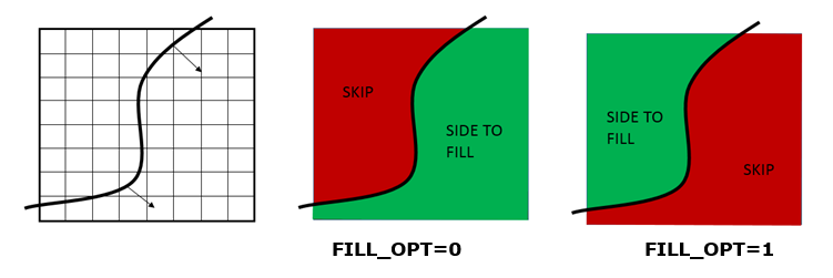

= 0
Filling the side which along normal direction
= 1
Filling the side which against normal direction
Figure 3.

Remove the previous material and then fill new material or mixed
FILL_RATIO
Ratio of filling material

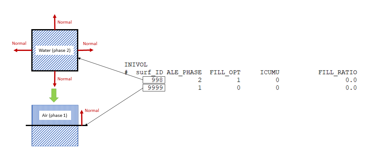

/INIVOL uses successive filling actions of the initial background multi-material ALE mesh, to get the final configuration of the initial volume fractions (three containers and three ALE phases). Initially the volume is filled by the first material defined in the /MAT/LAW51 field. In this case, the first material is air, so the entire hex mesh is first filled with air. Next, a surface is defined from the container part ID.
/SURF/PART/998
Vessel_Surf_Part
      85
Since the surface normal of container part point outside, use FILL_OPT = 1 to fill the water (phase 3) inside the container (filling the side which against surface normal direction).
/INIVOL/86/10003507
INIVOL
#  Surf_ID ALE_PHASE  FILL_OPT     ICUMU          FILL_RATIO
       998         2         1         0                 0.0
Now, ALE mesh is filled with ALE material 1 (air) from /MAT/LAW51 on the outside of the container and material 3 (water) inside the container. Lastly, define a surface plane, /SURF/PLANE to define the fill height. The normal of this plane points upward, use FILL_OPT = 0 to fill the air (phase 2) above the plane (filling the side along normal direction).
      9999         1         0         0                 0.0
ex_50_fill_opt
Figure 4.

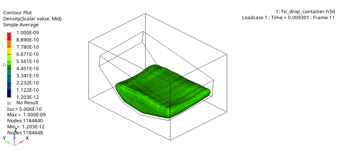

You can contour the model and use section cut to see inside, or use iso-surface, as shown in Figure 5.
ex_50_water_air
Figure 5.

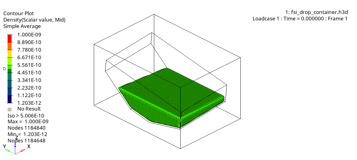

Results
To see the movement of the water in the container, and iso-surface plot of results type "density” can be done. If the simple averaging method is used in HyperView, the results will look smoother.
Water is starting to splash up the sides of the container at the end of the simulation.
ex_50_results
Figure 6.
