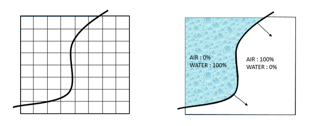

- During Starter execution, the elements
belonging to the PART defined by part_ID are filled with a given volumetric fraction depending on
ALE_PHASE value. The only requirement is that the element
is on the correct side of the given oriented surface. To fill the elements on
the opposite side of the surface normal, use the FILL_OPT
=1. In Figure 2 the green color indicates the side
of the surface which is filled by the /INIVOL option.

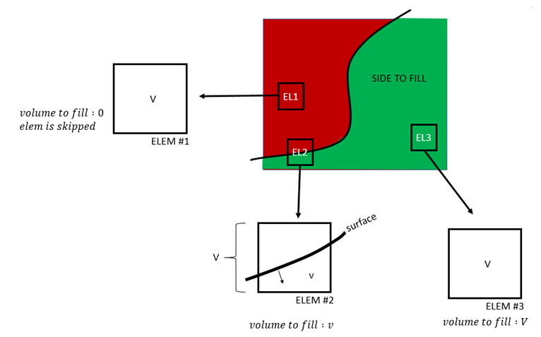

Figure 2. Surface side to fill can be reversed using flag FILL_OPT - If an element is crossed by the
surface, then it is not fully on one side. Then a volume estimation is made to
fill only the relevant sub-volume on the related side of the surface.
Figure 3. Element crossed by the surface has 2 sides. INIVOL option considers only relevant portion - ALE_PHASE is the multi-material ALE phase ID which is used to fill the given side of the surface. Since /MAT/LAW51 has 4 sub-materials, a value from 1 to 4 must be entered.

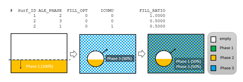

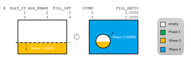

- ICUMU flag can be
used to add another material to a volume. For this purpose a
FILL_RATIO must be provided. By default,
ICUMU=0, which means that the existing
volumetric fraction initialized with a previous /INIVOL
process will be erased.
Figure 4. Filling with ICUMU = 0, erase existing filled volumes (default behavior)During the 2nd step, the volume outside the disc is filled with the phase 3 material.
Figure 5. Filling with ICUMU = 1, volumetric fraction is added into existing filled volumesDuring the 3rd step, the phase 1 material is added to the existing phase 3 material resulting in a 50% mixture of phase 1 and phase 3 material.

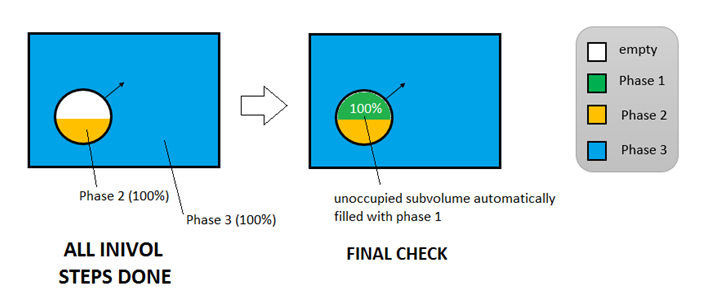

- A well-defined initial condition for
volumetric fraction is such that the volume fraction.
(1) Satisfies:(2) and(3) If this condition is not met after all /INIVOL processes, then:- If error message will be displayed.
- If phase 1 is used to fill the remaining unoccupied volume.
Unoccupied sub-volume are automatically filled with phase 1 after all execution of /INIVOL options to ensure that element volume is correctly partitioned.
Figure 6. Unoccupied sub-volume are automatically filled with phase 1 - Supported surfaces are:
