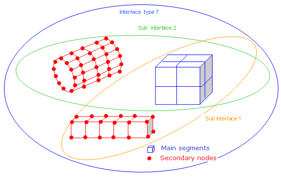

Block Format Keyword Defines a sub-interface. A sub-interface is a portion of (may include all of) an existing interface and is defined in order to output the forces applied by nodes of a specified node group on the segments of a specified surface (refer to Time Histories output for interfaces).

- For sub-interfaces of TYPE7 TYPE10, TYPE11, TYPE19 and TYPE24:
All nodes defined by Second_ID should belong to the secondary nodes group of the interface.
All segments of the specified main surface or main line in the sub interface should belong to the main surface or main line of the interface.
All segments of the specified secondary surface or secondary line in the sub interface should belong to the secondary surface or secondary line of the interface.
