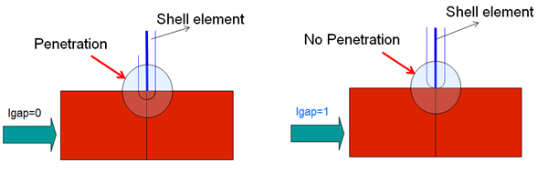

- If Igap = 1, the gap is
computed for each impact as:
(2) With,- gm: main element gap:
, with t is the thickness of the main element for shell elements
gm = 0 for brick elements
- gs: secondary node
gap:
gs = 0 if the secondary node is not connected to any element or is only connected to brick or spring elements.
, with t is the largest thickness of the shell elements connected to the secondary node.
for truss and beam elements, with S being the cross section of the element.
If the secondary node is connected to multiple shells and/or beams or trusses, the largest computed secondary gap is used.
If the free edge of a shell element is in contact, then Igap can shift the gap of the free edges border shells, as:
