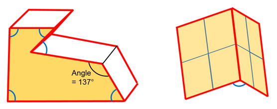

| Iedge | Edge to edge contact flag.
(Integer) |
| Edge_angle | Edge angle. Only used if Iedge =1. Sharp edges are included in edge contact if the angle between two segments which share the same edge is smaller than Edge_angle value. 9 Default = 135° (Real) |
| Gap_max_s | Secondary maximum gaps.
