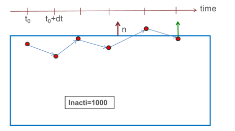

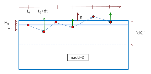

Inacti Initial penetration flag.
=-1
All initial penetrations are taken into account.
=0
Set to the value defined in /DEFAULT/INTER/TYPE25.
=5
The main segment is shifted by the initial penetration value P 0 .
If P P 0 , then P ' = P P 0 , where P 0 is the initial penetration.
=1000 Default, if /DEFAULT/INTER/TYPE25 is not defined
Only tiny initial penetrations will be taken into account.
(Integer)

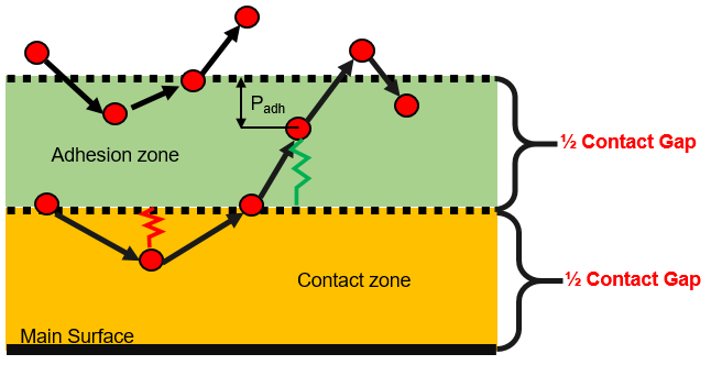

IVIS2 Interface adhesion flag. 12
=0 (Default)
No adhesion interface forces.
=-1
Enable transverse adhesion and tangential viscous force.
(Integer)
ViscFluid Viscosity of the fluid at the interface. 12
(Real)
[ Pas ]
SigMaxAdh Maximum transverse adhesive stress at interface. 12
(Real)
[ Pa ]
ViscAdhFact Tangential viscous resistant force scaling factor. 12
(Real)

  9. Inacti and Ipen_max, initial penetration treatment:
    • Inacti = 1000: The initial penetrations are ignored: no contact forces are applied, but the nodes are not deactivated from the contact; if the node goes out of the contact and later gets back into contact, contact forces are then applied.
      inter_type24_inacti=1000
      Figure 8.

    • Inacti = 5: The main segment is shifted by the initial penetration value ( P 0 MathType@MTEF@5@5@+= feaagKart1ev2aqatCvAUfeBSjuyZL2yd9gzLbvyNv2CaerbuLwBLn hiov2DGi1BTfMBaeXatLxBI9gBaerbd9wDYLwzYbItLDharqqtubsr 4rNCHbGeaGqiVu0Je9sqqrpepC0xbbL8F4rqqrFfpeea0xe9Lq=Jc9 vqaqpepm0xbba9pwe9Q8fs0=yqaqpepae9pg0FirpepeKkFr0xfr=x fr=xb9adbaqaaeGaciGaaiaabeqaamaabaabaaGcbaGaamiuamaaBa aaleaacaaIWaaabeaaaaa@37B2@ ); therefore, at time zero no initial forces are applied.
    The main segment position is restored only in case of rebound larger than P 0 MathType@MTEF@5@5@+= feaagKart1ev2aqatCvAUfeBSjuyZL2yd9gzLbvyNv2CaerbuLwBLn hiov2DGi1BTfMBaeXatLxBI9gBaerbd9wDYLwzYbItLDharqqtubsr 4rNCHbGeaGqiVu0Je9sqqrpepC0xbbL8F4rqqrFfpeea0xe9Lq=Jc9 vqaqpepm0xbba9pwe9Q8fs0=yqaqpepae9pg0FirpepeKkFr0xfr=x fr=xb9adbaqaaeGaciGaaiaabeqaamaabaabaaGcbaGaamiuamaaBa aaleaacaaIWaaabeaaaaa@37B2@ .
    In the opposite case, when secondary node continues to penetrate, the penetration is computed as:(11)
    P ' = P P 0
    inter_type24_inacti=5
    Figure 9.

  12. IVIS2=-1: is used to add adhesion in the normal direction and viscous resistive forces in the tangential direction. This can be used to model thermoplastic composite forming.
    When used, half of the contact gap is considered an adhesive zone and the other half a physical contact zone. Therefore, to maintain the same physical contact gap, the contact thickness should be doubled using Gap_scale.
    Figure 10.
    The adhesive force is only applied after secondary nodes have entered the physical contact zone and then move back into the adhesion zone. The adhesive force acts to prevent the node from moving out of the adhesion zone and is applied in the normal direction.(12)
    F N = S i g M a x A d h A r e a 1 2 G a p ( 1 2 G a p P a d h ) MathType@MTEF@5@5@+= feaagKart1ev2aaatCvAUfeBSjuyZL2yd9gzLbvyNv2CaerbuLwBLn hiov2DGi1BTfMBaeXatLxBI9gBaerbd9wDYLwzYbItLDharqqtubsr 4rNCHbGeaGqiVu0Je9sqqrpepC0xbbL8F4rqqrFfpeea0xe9Lq=Jc9 vqaqpepm0xbba9pwe9Q8fs0=yqaqpepae9pg0FirpepeKkFr0xfr=x fr=xb9adbaqaaeGaciGaaiaabeqaamaabaabaaGcbaGaamOramaaBa aaleaacaWGobaabeaakiabg2da9maalaaabaGaam4uaiaadMgacaWG NbGaamytaiaadggacaWG4bGaamyqaiaadsgacaWGObGaeyyXICTaam yqaiaadkhacaWGLbGaamyyaaqaamaalaaabaGaaGymaaqaaiaaikda aaGaam4raiaadggacaWGWbaaaiaacIcadaWcaaqaaiaaigdaaeaaca aIYaaaaiaadEeacaWGHbGaamiCaiabgkHiTiaadcfadaWgaaWcbaGa amyyaiaadsgacaWGObaabeaakiaacMcaaaa@5523@
    Where,
    A r e a MathType@MTEF@5@5@+= feaagKart1ev2aaatCvAUfeBSjuyZL2yd9gzLbvyNv2CaerbuLwBLn hiov2DGi1BTfMBaeXatLxBI9gBaerbd9wDYLwzYbItLDharqqtubsr 4rNCHbGeaGqiVu0Je9sqqrpepC0xbbL8F4rqqrFfpeea0xe9Lq=Jc9 vqaqpepm0xbba9pwe9Q8fs0=yqaqpepae9pg0FirpepeKkFr0xfr=x fr=xb9adbaqaaeGaciGaaiaabeqaamaabaabaaGcbaGaamyqaiaadk hacaWGLbGaamyyaaaa@3983@
    Area of the secondary surface
    P a d h MathType@MTEF@5@5@+= feaagKart1ev2aaatCvAUfeBSjuyZL2yd9gzLbvyNv2CaerbuLwBLn hiov2DGi1BTfMBaeXatLxBI9gBaerbd9wDYLwzYbItLDharqqtubsr 4rNCHbGeaGqiVu0Je9sqqrpepC0xbbL8F4rqqrFfpeea0xe9Lq=Jc9 vqaqpepm0xbba9pwe9Q8fs0=yqaqpepae9pg0FirpepeKkFr0xfr=x fr=xb9adbaqaaeGaciGaaiaabeqaamaabaabaaGcbaGaamiuamaaBa aaleaacaWGHbGaamizaiaadIgaaeqaaaaa@39B3@
    Penetration into the adhesion zone
    G a p MathType@MTEF@5@5@+= feaagKart1ev2aaatCvAUfeBSjuyZL2yd9gzLbvyNv2CaerbuLwBLn hiov2DGi1BTfMBaeXatLxBI9gBaerbd9wDYLwzYbItLDharqqtubsr 4rNCHbGeaGqiVu0Je9sqqrpepC0xbbL8F4rqqrFfpeea0xe9Lq=Jc9 vqaqpepm0xbba9pwe9Q8fs0=yqaqpepae9pg0FirpepeKkFr0xfr=x fr=xb9adbaqaaeGaciGaaiaabeqaamaabaabaaGcbaGaam4raiaadg gacaWGWbaaaa@389D@
    Contact gap as calculated in Comment 3
    The adhesive spring ruptures as the node exits the adhesion zone and will be recreated if the node enters the contact zone again.
