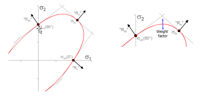

The Vegter yield locus, under plane stress conditions, is obtained by defining three second order Bezier interpolation curves in the principal stresses space (Figure 1).
Figure 1. Yield criterion defined by the classic Vegter formulation in plane-stress (Icrit=1)These curves are used to link four reference points which are measured experimentally at different loading conditions: shear, uniaxial tension, plane strain, and equibiaxial tension. Between two reference points, the yield locus is then defined in:(2) Where,- ,
- Two reference points.
- Hinge point, which is computed automatically.
- Parameter computed at each time step to determine the position on the yield locus.
The four measured reference points are referred to as: , , , and . The coordinates of these reference points are provided by you.
Where, = , , . For a given direction with respect to the rolling direction, only one component must be set for the shear , uniaxial tension , and equibiaxial tension reference point . For the plane-strain reference point, the two components and must be provided by you.
There is a freedom on the choice of the second coordinate . If it is not set, its value will be taken as an average of the second coordinates of the two neighboring hinge points.
The hinge point located between two reference points is computed using the reference points coordinates, but also the normal to the yield surface in each reference point. Using the normality rule, the normal to the yield surface can be expressed using the strain rate tensor component:(3) Where, is the strain rate ratio in a given reference point. For the shear reference point, . For the plane-strain reference point, . For the uniaxial tension reference point, this ratio can be computed from the Lankford coefficient denoted :(4) The Lankford coefficient must be provided by you. Finally, the strain rate ratio in the equibiaxial tension must also be set.

- If
= 4, the law uses the
simplified Vegter Lite yield criterion which is defined by:
(6) Where,- Yield function.
- Yield stress.
- Interpolated Vegter equivalent stress.
The Vegter yield locus, under plane stress conditions, is obtained by defining two second order Nurbs interpolation curves in the principal stresses space. These curves are used to link three reference points which are measured experimentally at different loading conditions: uniaxial compression, uniaxial tension, and equibiaxial tension. Between two reference points, the yield locus is then defined in:(7) (8) Where,- ,
- Weight factor associated with the hinge point.
Figure 2. Yield criterion defined by the classic Vegter formulation in plane-stress (Icrit=2)In Figure 2, yield criterion is defined by the classic Vegter formulation in plane-stress ( = 2).
As for the classical Vegter formulation, you must set the parameters , , , and . In this simplified formulation, the two hinge points are in pure shear and plane strain condition. The two associated weight factors and must also be defined.

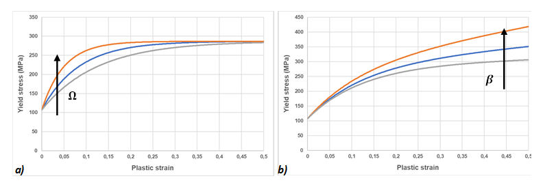

- The yield stress
is defined by the following expression:
(13) Where,- Initial yield stress.
- Hardening stress increment.
- Large strain hardening parameter.
- Initial plastic strain.
- Small strain hardening parameter.
- Hardening exponent.
- Limit dynamic flow stress.
- Boltzmann constant.
- Temperature.
- Maximum activation enthalpy.
- Inviscid limit strain rate.
- Strain rate dependence exponent.
The parameter, is called small strain hardening parameter, as its effect has a strong influence on the hardening curve at small strain (Figure 3a). Similarly, the large strain hardening parameter has a bigger influence at large strain (Figure 3b).

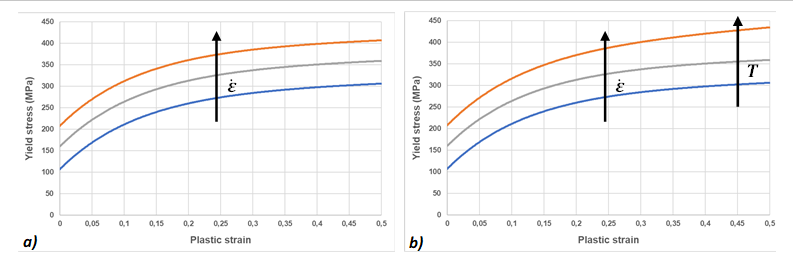

Figure 3. Effect of hardening parameter on the yield stress evaluation - If Tini is defined, the temperature will be constant at the Tini value over the simulation. This will enable a constant strain rate
dependency (Figure 4a).If you want to compute a temperature evolution to take into account the thermal activation effect (slight increase of strain rate dependency following the increase of the temperature), the option /HEAT/MAT must be defined (Figure 4a).
Figure 4. Effect of temperature setting on the strain rate dependency - The strain rate

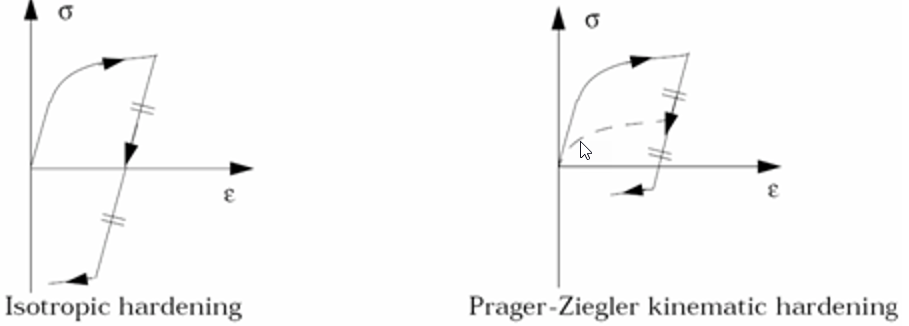

- You might also want to use a kinematic hardening by setting coefficient Chard:
- If Chard = 0: the isotropic hardening is used.
- If Chard = 1: the Prager-Ziegler kinematic hardening is used.
- If 0 ≤ Chard ≤ 1: the model is interpolated between the
isotropic and the kinematic hardening.
Figure 5.
