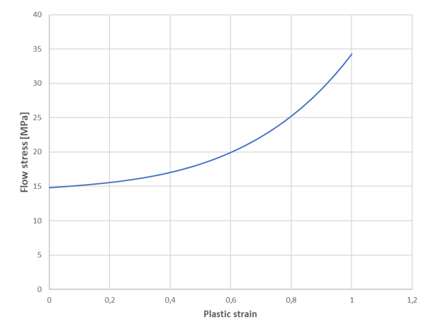

(4) With the flow stress defined by (Figure 1):(5) Where,- Initial flow stress.
- Linear hardening modulus.
- Densification strain.
- Nonlinear hardening modulus.
- Nonlinear hardening exponent.
Figure 1. Flow stress evolution with plastic strain - Two versions of

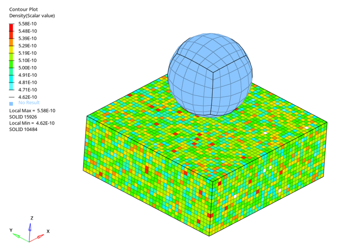

- When using
Istat =
1, the card /PERTURB/PART/SOLID must
be set to create the initial foam density
distribution over all elements of the part (Figure 2).
