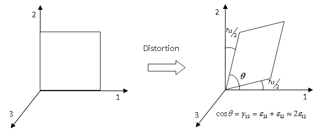

- Stress-strain relation in
elastic phase.The stresses and strains are related as:
(1) (2) (3) (4) Where,- Strains
- Stresses
- , and
- Distortions in the corresponding material directions
Figure 1. - Tsai-Wu criterion:The material is assumed to be elastic until the Tsai-Wu criterion is fulfilled. After exceeding the Tsai-Wu criterion limit , the material becomes nonlinear:
