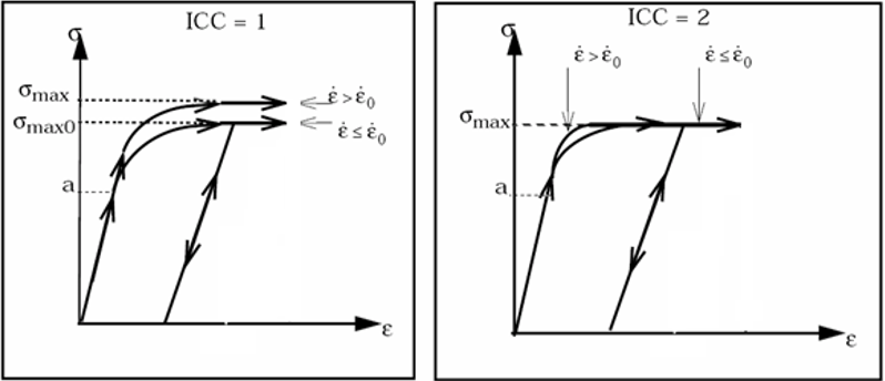

- The ICC flag defines the effect
of strain rate on the maximum material stress
. Figure 1 shows the value of
for the corresponding ICC flag.

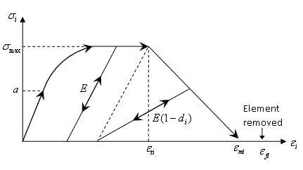

- When principal strain
becomes higher than
, then damage between
and
is controlled by the damage factor
, which is given by the following equation.
in directions, = 1, 2.
Stress is reduced according to damage parameter . Damage is reversible between and . When , damage is set to and it is not updated further.
