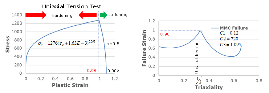

Example (Metal)
#RADIOSS STARTER
/UNIT/1
unit for mat
g mm ms
#- 2. MATERIALS:
/MAT/LAW72/1/1
Metal
# RHO_I
0.0028
# E nu
200E+3 0.3
# Sig0 Eps0 n F G
1276 1.63E-3 0.265 0.5 0.5
# H N L M
0.5 1.5 0 0
# C1 C2 C3 m Dc
0.12 720 1.095 0.5 1.1
#ENDDATA
/END

- Fracture and damage with MMC
fracture criteria:
- When D = 1: fracture initiate
- By 1 < D <
Dc: the yield stress is multiplied
by softening function
to reduce the deformation resistance.
with
- If D ≥ Dc, the element is deleted.

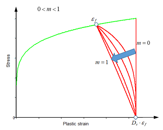

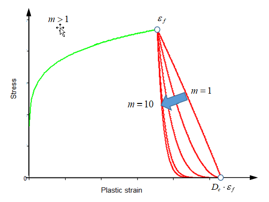

- The exponent m is used to describe the softening behavior. It is
recommended to use m > 0.
If 0 < m < 1, then the softening curve is convex.
If m > 1, then the softening curve is concave. The softening is between and . Once the plastic strain is reached (in this case ), then the element is deleted.
Figure 3.
