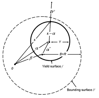

- The schematic illustration of the
two-surface model is shown in Figure 1.
Where, 0 is the original center of the yield surface, the yield surface with its center and its radii Y, is moving kinematically, within a bounding surface that has a size indicated by B+R and tensor indicating its center position.
Figure 1. Schematic Drawing of the Two-surface Model - The yield surface is subjected to a kinematic
