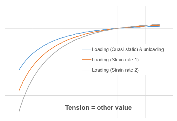

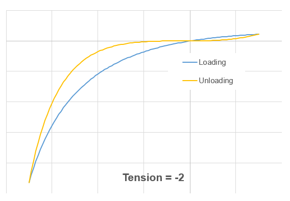

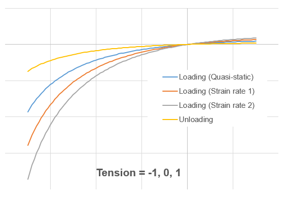

- The loading and unloading curves are
defined with positive stress and strain in tensile and negative stress and strain in
compression.The following curves are needed according to Tension flag:
- Tension = -1, 0, or
1
Figure 1. - Tension = -2
Figure 2. - Tension = other value
Figure 3.
