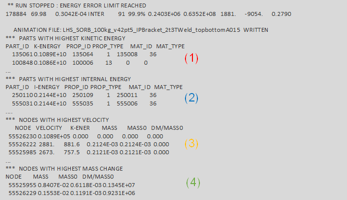

For example, in the case below, the information provided at the end of the _0001.out is very useful in trying to understand the area of the model causing the simulation to stop.
The solver reports:- Which parts have the highest kinetic (1) / internal energy (2)
- Which nodes have the highest velocity (3) / mass change (4)

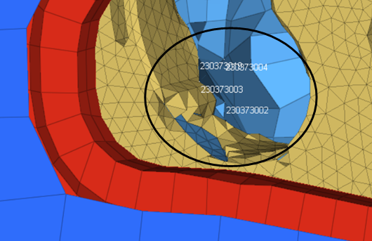

Figure 1.For example, in the case below, before the simulation fails with an error termination, the following message may be printed in the _0001.out:CYCLE TIME TIME-STEP ELEMENT ERROR I-ENERGY K-ENERGY T K-ENERGY R EXT-WORK MAS.ERR 62100 18.53 0.2985E-03 SOLID 230440718 -1.3% 0.3484E+05 0.1313E+06 109.7 1523. RUPTURE OF SOLID ELEMENT NUMBER 230025298 DELETE CONNECTION SOLID ELEMENT 110010956, ENERGY= 4.732011155E-05 RUPTURE OF SOLID ELEMENT NUMBER 230024559 **WARNING MINIMUM TIME STEP 0.5976E-05 IN INTERFACE NB 2300040(DTMIN= 0.1000E-04) SECONDARY NODES NB 230373002 230373019 MAIN NODES NB 230373003 230373004 DELETE SECONDARY LINE FROM INTERFACE
An initial intersection causes high distortion and eventually ERROR termination.

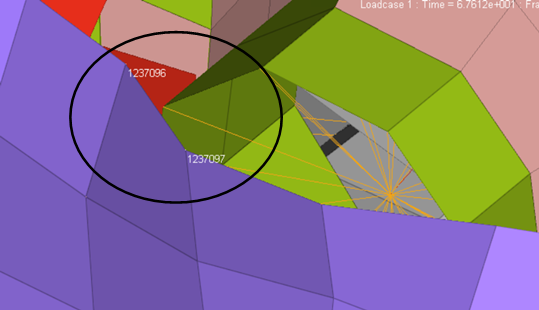

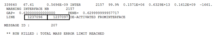

Figure 2.For example, in the case below, the run is killed, due to contact with a rigid causes the ERROR termination. The output file prints:
Figure 3.
Figure 4.
