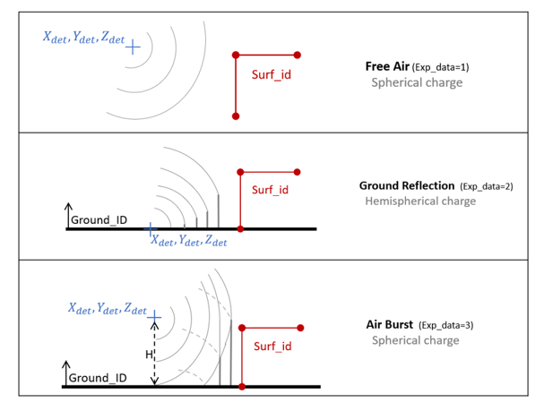

- Modeling situation is set with
Exp_data flag. You provide explosion data
(Xdet,
Ydet,
Zdet), explosion mass
(WTNT) target surface
(surf_ID), and detonation time
(Tdet). All other
parameters and flags have default values.If Exp_data=3, explosive height must be defined.

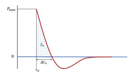

Figure 1.At a given point over the user surface, the corresponding radius and the explosive mass WTNT is used to determine characteristic values of the blast wave (arrival time , maximum pressure Pmax, positive duration , impulse , ...) . Both incident wave and reflected wave are to follow Friedlander’s equation:- If
Imodel = 1
(Friedlander model)
(1) - If
Imodel = 2
(modified Friedlander model)
(2)
Where, are experimentally known at a given scaled distance . 3
With the modified Friedlander model (Imodel=2), ‘b’ is a decay parameter introduced to fit the positive impulse.
'b’ is solved such as:(3)
Figure 2. Blast profile from Friedlander equation - If

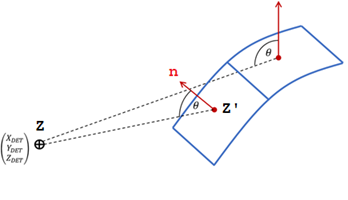

at a given face centroid Z’ (Figure 3).
2
(4)
Figure 3. Blast pressure applied on a face centroid Z’ . depends on face orientationWhere, is the angle between the surface segment (centroid Z’) and the direction to detonation point.
This means that blast pressure is equal to reflected pressure if segment is directly facing the detonation point, and equal to incident pressure if segment is not facing the detonation point. This modeling is simple because arrival time and incident pressure are not adjusted with shadowing of the related structure. It also does not into account confinement and tunnel effect.
This also requires the surface to have outward normal vector.

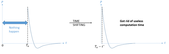

- It is possible to skip computation time from
to
. The shift value is automatically computed
during Starter execution. To disable a computation up to
, the I_tshift value must be
equal to 2.

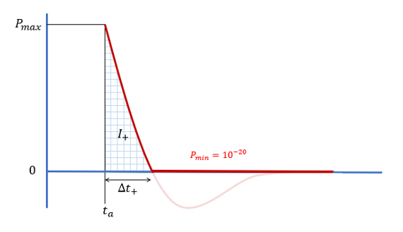

Figure 5. - Parameter
was introduced to keep positive part of
Friedlander blast model.
(5)
Figure 6. Parameter
used to keep only overpressure (positive
part of the loading)
