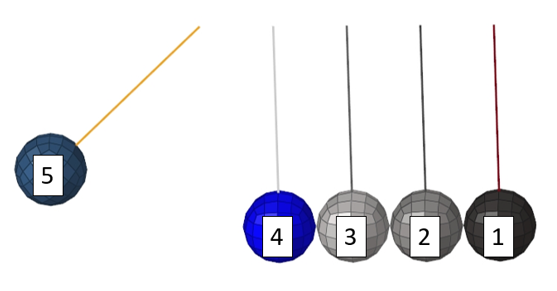

Five pendulums in line, initially in contact with each other, are struck by a sixth one. The shock wave and oscillating motion are observed.

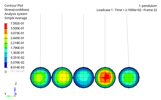

When considering the kinetic energy variation of the model, the system behaves as a simple pendulum (Figure 3).

Figure 3. Pendulum Motion

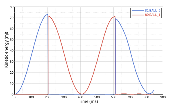

Figure 4. Kinetic Energy Transfer between Ball 5 and Ball 1

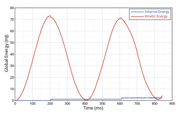

Figure 5. Global Internal and Kinetic Energy

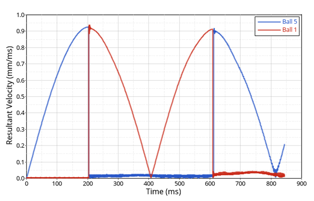

Figure 6. Velocity Curve of Ball 5 and Ball 1
