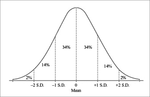

- This option is multiplying generated real values (following the defined normal distribution) to shell thicknesses of selected group of part.
- Curve of probability density
function:
Figure 1. - Seed is an integer corresponding to the value used to initialize random number generation that should use for sensitivity analysis or model robustness investigation purpose.
- Two computations with the same values, Seed will return exactly to the same results.
- If random value is > Max_cut, random value is replaced with Max_cut.
- If random value is < Min_cut, random value is replaced with Min_cut.
