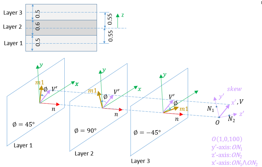

Example
3 layers (N=3) with different material, different material direction (m1). Reference vector is taken from x-axis of skew.
prop_type11_example
#RADIOSS STARTER
#-  1. LOCAL_UNIT_SYSTEm:
/UNIT/2
unit for prop
#              MUNIT               LUNIT               TUNIT
                  kg                  mm                  ms
/SKEW/FIX/1
New SKEW 1
#                 OX                  OY                  OZ
                 1.0                   0               100.0
#                 X1                  Y1                  Z1
                   0                   0                   1
#                 X2                  Y2                  Z2
                   0                  -1                   0
#-  2. GEOMETRICAL SETS:
/PROP/SH_SANDW/2/2
SH_SANDW example
#   Ishell    Ismstr     Ish3n     Idril                             Pthick_fail
        12         0         0         0                                       0
#                 hm                  hf                  hr                  dm                  dn
                   0                   0                   0                  .1                  .1
#        N                         Thick              Ashear              Ithick     Iplas
         3                           1.6                   0                   1         1
#                 Vx                  Vy                  Vz   skew_ID     Iorth      Ipos        Ip
                   0                   0                   0         1         0         0         0
#                Phi                   t                   Z    mat_ID                     F_weighti
                  45                  .5                   0         1                             0
                  90                  .6                   0         2                             0
                 -45                  .5                   0         1                             0
#enddata

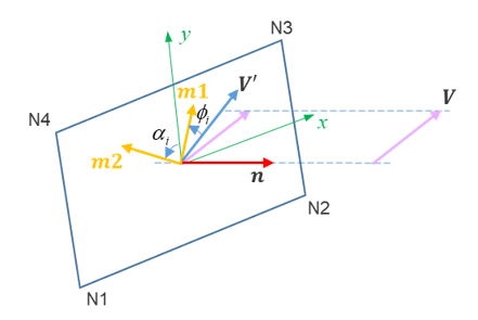

  8. Anisotropy direction definition.
    The reference vector V MathType@MTEF@5@5@+= feaagKart1ev2aaatCvAUfeBSjuyZL2yd9gzLbvyNv2CaerbuLwBLn hiov2DGi1BTfMBaeXatLxBI9gBaerbd9wDYLwzYbItLDharqqtubsr 4rNCHbGeaGqipu0Je9sqqrpepC0xbbL8F4rqqrFfpeea0xe9Lq=Jc9 vqaqpepm0xbba9pwe9Q8fs0=yqaqpepae9pg0FirpepeKkFr0xfr=x fr=xb9adbaqaaeGaciGaaiaabeqaamaabaabaaGcbaGaaCOvaaaa@36B5@ is defined as following according to the flag IP:
    • If IP=0 and skew_ID = 0, the reference vector V MathType@MTEF@5@5@+= feaagKart1ev2aaatCvAUfeBSjuyZL2yd9gzLbvyNv2CaerbuLwBLn hiov2DGi1BTfMBaeXatLxBI9gBaerbd9wDYLwzYbItLDharqqtubsr 4rNCHbGeaGqipu0Je9sqqrpepC0xbbL8F4rqqrFfpeea0xe9Lq=Jc9 vqaqpepm0xbba9pwe9Q8fs0=yqaqpepae9pg0FirpepeKkFr0xfr=x fr=xb9adbaqaaeGaciGaaiaabeqaamaabaabaaGcbaGaaCOvaaaa@36B5@ is defined with VX, VY and VZ.
    • If IP=0 and skew_ID ≠ 0, the reference vector V MathType@MTEF@5@5@+= feaagKart1ev2aaatCvAUfeBSjuyZL2yd9gzLbvyNv2CaerbuLwBLn hiov2DGi1BTfMBaeXatLxBI9gBaerbd9wDYLwzYbItLDharqqtubsr 4rNCHbGeaGqipu0Je9sqqrpepC0xbbL8F4rqqrFfpeea0xe9Lq=Jc9 vqaqpepm0xbba9pwe9Q8fs0=yqaqpepae9pg0FirpepeKkFr0xfr=x fr=xb9adbaqaaeGaciGaaiaabeqaamaabaabaaGcbaGaaCOvaaaa@36B5@ is the first direction (local X) of the local coordinate system skew_ID.
    • If IP = 20, the reference vector V MathType@MTEF@5@5@+= feaagKart1ev2aaatCvAUfeBSjuyZL2yd9gzLbvyNv2CaerbuLwBLn hiov2DGi1BTfMBaeXatLxBI9gBaerbd9wDYLwzYbItLDharqqtubsr 4rNCHbGeaGqipu0Je9sqqrpepC0xbbL8F4rqqrFfpeea0xe9Lq=Jc9 vqaqpepm0xbba9pwe9Q8fs0=yqaqpepae9pg0FirpepeKkFr0xfr=x fr=xb9adbaqaaeGaciGaaiaabeqaamaabaabaaGcbaGaaCOvaaaa@36B5@ is defined with the node N1 and N2 of the shell elements.
    • If IP = 22, the reference vector V MathType@MTEF@5@5@+= feaagKart1ev2aaatCvAUfeBSjuyZL2yd9gzLbvyNv2CaerbuLwBLn hiov2DGi1BTfMBaeXatLxBI9gBaerbd9wDYLwzYbItLDharqqtubsr 4rNCHbGeaGqipu0Je9sqqrpepC0xbbL8F4rqqrFfpeea0xe9Lq=Jc9 vqaqpepm0xbba9pwe9Q8fs0=yqaqpepae9pg0FirpepeKkFr0xfr=x fr=xb9adbaqaaeGaciGaaiaabeqaamaabaabaaGcbaGaaCOvaaaa@36B5@ is the first direction (local X) of the local coordinate system skew_ID. Vector components VX, VY and VZ are ignored.
    • If IP = 23, the reference vector V MathType@MTEF@5@5@+= feaagKart1ev2aaatCvAUfeBSjuyZL2yd9gzLbvyNv2CaerbuLwBLn hiov2DGi1BTfMBaeXatLxBI9gBaerbd9wDYLwzYbItLDharqqtubsr 4rNCHbGeaGqipu0Je9sqqrpepC0xbbL8F4rqqrFfpeea0xe9Lq=Jc9 vqaqpepm0xbba9pwe9Q8fs0=yqaqpepae9pg0FirpepeKkFr0xfr=x fr=xb9adbaqaaeGaciGaaiaabeqaamaabaabaaGcbaGaaCOvaaaa@36B5@ is defined with VX, VY and VZ. Local coordinate system skew_ID is ignored.
    The reference vector V MathType@MTEF@5@5@+= feaagKart1ev2aaatCvAUfeBSjuyZL2yd9gzLbvyNv2CaerbuLwBLn hiov2DGi1BTfMBaeXatLxBI9gBaerbd9wDYLwzYbItLDharqqtubsr 4rNCHbGeaGqipu0Je9sqqrpepC0xbbL8F4rqqrFfpeea0xe9Lq=Jc9 vqaqpepm0xbba9pwe9Q8fs0=yqaqpepae9pg0FirpepeKkFr0xfr=x fr=xb9adbaqaaeGaciGaaiaabeqaamaabaabaaGcbaGaaCOvaaaa@36B5@ is projected on the shell element plane and becomes the vector V . For IP=23, vector V MathType@MTEF@5@5@+= feaagKart1ev2aaatCvAUfeBSjuyZL2yd9gzLbvyNv2CaerbuLwBLn hiov2DGi1BTfMBaeXatLxBI9gBaerbd9wDYLwzYbItLDharqqtubsr 4rNCHbGeaGqipu0Je9sqqrpepC0xbbL8F4rqqrFfpeea0xe9Lq=Jc9 vqaqpepm0xbba9pwe9Q8fs0=yqaqpepae9pg0FirpepeKkFr0xfr=x fr=xb9adbaqaaeGaciGaaiaabeqaamaabaabaaGcbaGaaCOvaaaa@36B5@ after projection is additionally multiplied by shell normal vector to become V Then for each layer, the 1st material direction (m1) is vector V turned ϕ i degrees (turns positive direction around shell normal n ).
    prop_type9_v10
    Figure 2. IP ≠ 23
    Figure 3. IP = 23
    The hierarchy order to define the reference vector V is:
    • initial state card (/INISHE/ORTHO)
    • shell property
    In case of reference metrics, the orientation for directions of anisotropy must be defined with the reference geometry, not the initial one.
    The 2nd material direction m2 derived from direction m1 rotated 90 degrees (orthotropic).
