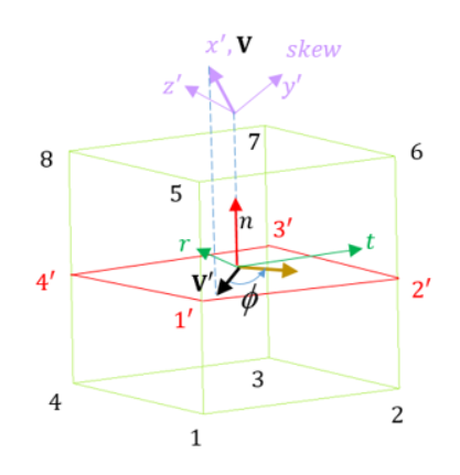

Example
Figure 1. Skew and Angle to Define the Material Direction (Fiber Direction) m1
#RADIOSS STARTER
#- 1. SKEWS & FRAMES:
/SKEW/FIX/1
New SKEW 1
# OX OY OZ
0 100 0
# X1 Y1 Z1
1 1 0
# X2 Y2 Z2
-.408248290463863 .408248290463863 .816496580927726
#- 2. LOCAL_UNIT_SYSTEm:
/UNIT/2
unit for prop
# MUNIT LUNIT TUNIT
kg mm ms
#- 3. GEOMETRICAL SETS:
/PROP/TYPE21/1/2
TSH_ORTH example
# Isolid Ismstr Icstr Inpts dn
14 0 010 222 0
# q_a q_b
0 0
# Vx Vy Vz skew_ID Iorth
0 0 0 1 0
# Ortho_angle
90
# deltaT_min vdef_min vdef_max ASP_max COL_min
0 0 0 0 0
#enddata

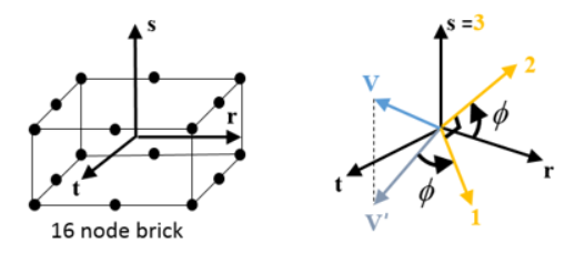

- Thickness direction:
- By default, the element must be oriented so that the thickness direction of the thick shell is in the elements "s" direction.
- However, when using Isolid=14 (HA8), a different thickness direction can be specified using the
constant stress flag, Icstr. Note: Check the elements local system orientation using a pre-processor.
Figure 2.- r, s, t
- Isoparametric frame
- r
- Center of (1, 2, 6, 5) to center of (4, 3, 7, 8)
- s
- Center of (1, 2, 3, 4) to center of (5, 6, 7, 8)
- t
- Center of (1, 4, 8, 5) to center of (2, 3, 7, 6)
- Icstr - for reduced stress integration.For Isolid=14 (HA8) the reduced integration direction and thus thickness direction of the shell can be set by parameter Icstr. This parameter represents a 3-digit sequence of "0" and "1", which corresponds to standard r-s-t elemental coordinate system for solid elements.
- 0
- No reduced stress integration is done in corresponding direction.
- 1
- Reduced integration is used in this direction.
For example:
"010" means that reduced integration is used and the thickness direction corresponds to element axis "s".

- Othotropy in local coordinate
system.
- The thick shell orthotropy is planar and the third orthotropy direction is coincident with the normal to the shell plane.
- Global vector or skew_ID is used to define the othotropy direction.
is the angle between the first direction of
orthotropy and projection of reference vector on the shell mean plane (r
and t). It is given in degrees.
Figure 3.
