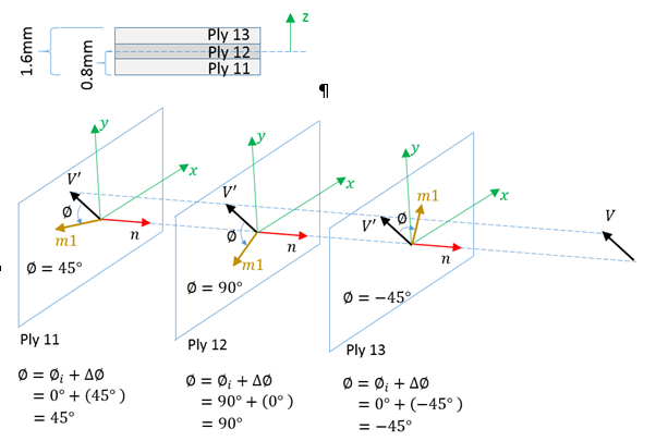

Example (Ply)
There are three plies in this example. Each of the three plies in this example has a different material direction (fiber direction) and a different material (which is defined in each ply with /PROP/TYPE19). Three integration points uniformly distributed throughout each ply.
prop_type51_example
#RADIOSS STARTER
/UNIT/2
unit for prop
#              MUNIT               LUNIT               TUNIT
                  kg                  mm                  ms
/PROP/TYPE51/2/2
composite combine by ply
#   Ishell    Ismstr     Ish3n    Idrill         Pthick_fail                  Z0
        12         0         0         1                   0                   0
#                 hm                  hf                  hr                  dm                  dn
                   0                   0                   0                  .1                  .1
#                                 Ashear                Iint              Ithick                Fexp
                                       0                   0                   1                 1.0
#                 VX                  VY                  VZ   skew_ID     Iorth      Ipos        Ip
                   1                   0                   1         0         0         0         0
# Pply_IDi                PHIi                  Zi       Pthickl_faili           F_weighti
        11                   0                   0                   0                   0
        12                  90                   0                   0                   0
        13                   0                   0                   0                   0
/PROP/TYPE19/11/2
PROP number 11
# mat_ID_i                   t           delta_phi id_grsh4n id_grsh3n   Npt_ply                 A_i
         1                  .5                  45         0         0         3                   0
/PROP/TYPE19/12/2
PROP number 12
         2                  .6                   0         0         0         3                   0
/PROP/TYPE19/13/2
PROP number 12
         1                  .5                 -45         0         0         3                   0
#enddata
