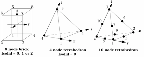

- Isoparametric systems
(r-s-t)For 8 node bricks (Isolid =1 or 2), 4-node tetrahedron and 10-node tetrahedron, the orthotropic system rotates like the orthogonalized isoparametric system. Attention must be paid to the orientation of the orthotropic system in case of large shear.
Figure 3.r, s, t: isoparametric frame
r: center of (1, 2, 6, 5) to center of (4, 3, 7, 8)
s: center of (1, 2, 3, 4) to center of (5, 6, 7, 8)
t: center of (1, 4, 8, 5) to center of (2, 3, 7, 6)

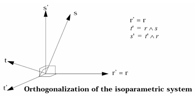

Figure 4. - Orthotropy

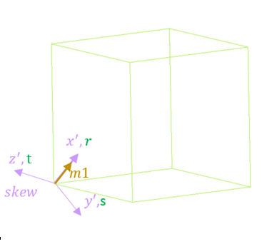

directionFor 3D solid elements, there are three different ways to define orthotropy direction:
- With Ip= 0 and
skew_ID ≠ 0, skew is used.
Then no reference plane is used; skew is taken directly as the orthotropic system (in this case r =x, s =y, and t =z). x-direction is orthotropy direction 1 and y-direction is orthotropy direction 2.

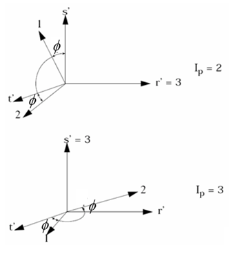

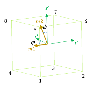

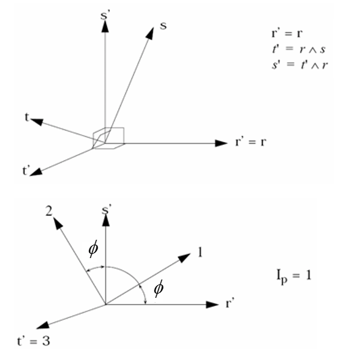

- With Ip = 1, 2 or
3, orthogonalized isoparametric system (r’-s’-t’) and orthotropic
angle are used:The orthotropic system initial orientation (1-2-3) is defined with respect to the initial orthogonalized isoparametric system (r’-s’-t’) , as:
Figure 5.
Figure 6.In this case, the orthotropic system initial orientation is defined the same way as for bricks, Isolid = 0, 1 or 2 (that is with respect to the orthogonalized isoparametric system), and knowledge of the co-rotational system orientation is unnecessary to input the orthotropic system initial orientation.

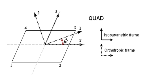

For 2D solid elements (/QUAD), there are two different ways to define orthotropy direction:- With Ip = 1, isoparametric system (r-s) and orthotropic angle are used. 10
- With Ip = 11, Reference vector is used: Global vector may be used to define the orthotropy direction. If this reference vector is orthogonal to plane, first axis of the plane (r-s) is taken as orthotropy direction.
- With Ip= 0 and
- orthotropic angle
For 2D solid elements (/QUAD):
Orthotropic angle is defined with respect to the first direction of the isoparametric frame (r-s).
Figure 7.For 3D solid elements:
