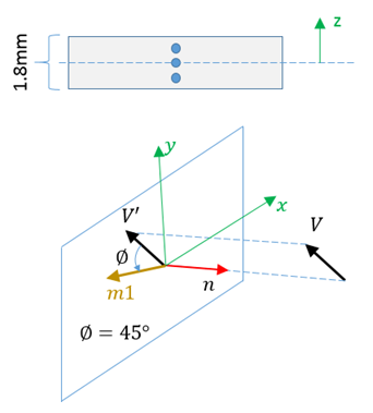

Example (Shell)
There are 3 integration points through the shell thickness. Material direction m1 (fiber direction) defined with vector V and angle ϕ .
prop_type9_example
#RADIOSS STARTER
#-  1. LOCAL_UNIT_SYSTEm:
/UNIT/2
unit for prop
#              MUNIT               LUNIT               TUNIT
                  kg                  mm                  ms
#-  2. GEOMETRICAL SETS:
/PROP/SH_ORTH/2/2
SH_ORTH example
#   Ishell    Ismstr     Ish3n    Idrill                             Pthick_fail
        12         0         0         1                                       0
#                 hm                  hf                  hr                  dm                  dn
                   0                   0                   0                  .1                  .1
#        N                         Thick              Ashear   skew_ID    Ithick     Iplas
         3                           1.8                   0         0         1         1
#                 Vx                  Vy                  Vz                 Phi                  Ip
                   1                   0                   1                  45                   0
#enddata
