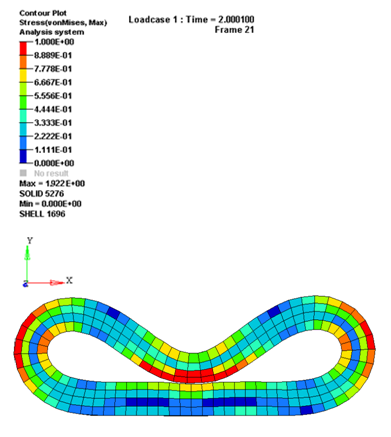

The stresses in the rubber ring after it has been crushed and sliding along the flat rigid surface are shown in Figure 8.
rubber_ring_stress
Figure 8. Stress in the Rubber Ring
